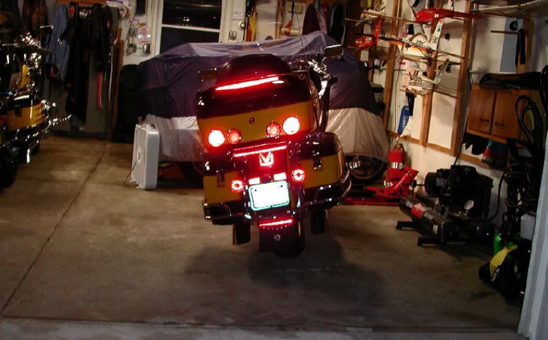

« Reply #10 on: May 11, 2009, 11:14:28 AM »
These can't be beat for value & brightness. I just glue one to the backs of the helmet locks on Interstates.
http://www.jcwhitney.com/autoparts/Product/Pr-p_Product.CATENTRY_ID:2011775/c-10101/Nty-1/p-2011775/Ntx-mode+matchallpartial/N-10101/tf-Browse/s-10101/Ntk-AllTextSearchGroup?Ntt=led+bar
Here's how one looks
