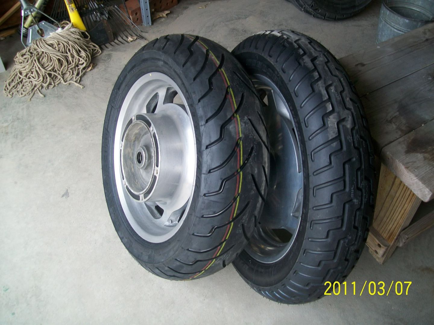

Time for a new front tire. I'm running a new-ish(4k miles) E3 on the rear. The bike currently has a D404 showing wear bars on the front. I'd like to keep the same brand front-rear, but am open to other suggestions of tires from dunlop if ya'll know of something better. So do I go back to the 404 or match out the E3?

I had E3s on her when I bought her, and the front had a wobble at speeds over 35 that I didn't like. It may have been due to wear, I don't know. I put a D404 on the front last spring when I installed the CT, and can ride for miles without touching the bars (I don't as a rule, just a test for stability). The E3s were replaced at over 20K miles, so they wear well. The D404 has 13K miles and shows no real wear so far (and it was $117. delivered).

+1 on the D404, I get 20k on the front, 20k on the rear American elite.  cooldude  Hoser

My D404 is a 150/80B/17 Front tire.  Can't match up no better than that .  Rear is a 180/65B/16 dunny. I got 20K out of them on my last set.  Needless to say I have another set on it now.  Hoser  cooldude
