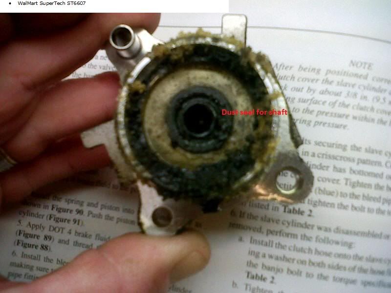

I had a similar issue with the clutch on my 1500 Wing.  Ended up being the slave cylinder.  The Wing was an '88 but only had about 50k on it.  As you can see by the picture, they get a little cruddy!
The seal was worn and bleeding off pressure.  Lots of room to get at it on the Valk compared to the Wing.  I had to pull the alternator to remove it.
