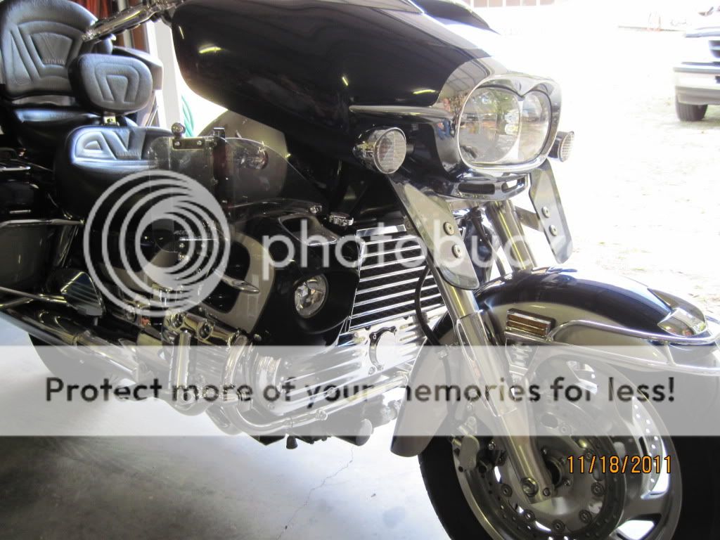

The fork deflectors definitely took care of the air coming up on my chest.
Fork Brackets - Memphis Shades # 9887
Deflectors - I made out of aluminum plate and had painted.

« Reply #11 on: January 09, 2012, 08:18:53 PM »
Nice work!
GJS
Posts: 424
Today is the tomorrow you worried about yesterday.
Vancouver Island, BC, Canada
« Reply #12 on: January 09, 2012, 10:10:07 PM »
Yes! Very nice work.
I'll buy a set if your ever selling. (unpainted would be best)

Flask, what did you cut the plates with?
Fred.
VRCCDS0237
Flask
Posts: 411
Inglis Florida
« Reply #14 on: January 10, 2012, 05:45:29 AM »
Fred.
Used 3/16" aluminum plate and cut with standard hand held jig saw.
Filed and sanded edges.
Kept playing with design to contour top side with fairing and also width size so when you turn handlebars to stop, they did not hit pods. You can play with adjustment on forks - be it height and angle to get clearances.

I'm currently working on a template/pattern to make a Lowers Mounting Bracket.   I'll have it scanned and burned on a plasma torch/table.    Most manufactured Lowers I see are more for show, and not a lot a wind deflection.
This is exactly why I made the ones you see above.
For the Interstate Fairing - It took care of the air coming up on my stomach / chest area.
Also had to take care in that they did not hit the pods when fully turned.
Looks like yours will be for Standard / Tourer.
