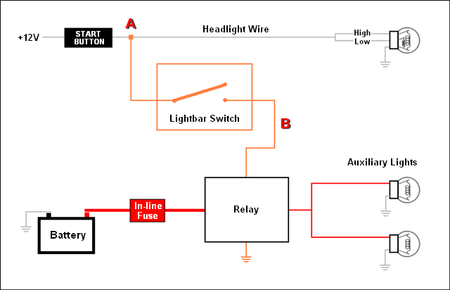

I'm off for my nightly ride so I'll get back later with more details. Basically, the general idea is that you have to determine if the +12 wire 'into' the switch has electricity to feed the switch's outbound wire to all points beyond. For example, your wall switch is fed electricity from the electirical panel and when you flip the switch, the same electricty then flows to the ceiling light on the same circuit. If the connection at electrical panel is faulty, even if you close the wall switch there's no electricity available to light up the ceiling light. But you don't want to be blaming the ceiling light or it's connection for something's that's at fault at the opposite end of the line. Step by step, process of elimination, and so forth. Several posters have guessed at a faulty switch which can be tested by touching the wires together.

.... What is the + 12 wire though?
+12v to the lightbar switch is usually done by tapping into the headlight wire at 'A' in the diagram below. Since you said your headlights work it follows you should have electricity at the switch. If you don't, I suspect that the vampire tap on the headlight wire is faulty. For now, you don't have to know what the headlight wire looks like. You can trace back the +12 wire from the lightbar switch, or look up the schemetic for the color of the headlight wire (R=red R/W=red wire with white stripe, etc).
The switch's outbound wire at 'B' doesn't (or shouldn't) go to the auxiliary lights. Instead the electricity is routed to an intermidiary 'relay.' [ A relay is an electro-magnet switch .... when electricity is sent to the relay, the electro magnet switch turns ON, and so forth.] With the relay in its ON state, electricity now flows from the battery to the auxiliary lights. *I suggest you check the inline fuse (red box).* It should be on one or the other side of the relay.
Perhaps, you should ask the PO whether ....
he used a relay? (see footnote, below)
if so, did he splice in an inline fuse?
which wire did he tap into to power the lightbar switch?
It might be a simple thing like both light bulbs went out at the same time. Best wishes.
*the below is meant more for rxvalk*
The reason that an intermidiary relay is necessary, is that the current for the headlight flows through the Start Button with the factory configuration. If you were to feed the headlight current directly to the auxiliary lights, the combined amp draw would eventually melt the nylon substrate in the start button. Start buttons aren't sold separately. You would have to purchase the entire right side housing to get a new start button. Thusly, relays are cheaper. The start button in this context is a known weak point on practically all bikes, not just on Honda's.
The headlight wire is usually tapped because it's conveniently nearby the lightbars. But the side benefit is that when you turn off the key, the headlights go OFF and anything tapped into the headlight circuit shuts off too .... so you won't have to remember to separately shut off the auxilliary lights and finding a dead battery the next morning. Lol, if you ever get them working again.
There's 4 female connectors that attach to the 4 relay prongs. Try wiggle them around to see if they're tight enough. Also, the cobra lightbars that I have (sealed beams) were grounded to the metal light shells. You might want to unscrew the rim and take a look inside at the connections. In my opinion, it's better to run dedicated ground wires back to the frame or battery neg. A caveat here though, when I ran ground wires from the auxiliary lights back to the frame, I had to snip the shell ground, otherwise the fuse kept tripping. For some odd reason, you can't have a double ground.
2000 Valkyrie Tourer

So I dug into it last night. It appears to be professionally put together as the wires all plugged into each other and had rubber covers which adequately covered each area. I am not exactly sure what a relay should look like so I am not sure if it has one or not. I touched the ground to the switch and looked for loose wires and could not find any. I put the headlight back together turned the key on and my speedo, tach, neutral light, stand and stand light were all out.
I thought great now I ve done it its more broke than it was to begin with. Checked the starter fuse, accessory fuse, and headligh fuse all were good. I called a friend who owns a valk and he asked me if the signals all worked and they did. We checked the brake light and it lit when the brake applied but did not come on otherwise. I pulled the side cover and the brake fuse was bad (all of these things were working before which is the strange part). I replaced the fuse and voila speedo, tach, brake light neutral switch and light bar lit up. Weird, I never would have thought to check the brake fuse had I not finished the fuse off when I tested ground I would not have found it. Weird that a fuse that is labeled as controlling things in the rear controls things in the front.
Thanks for all of your help, especially Ron W for the diagrams and Cajun rider for the initial response.
