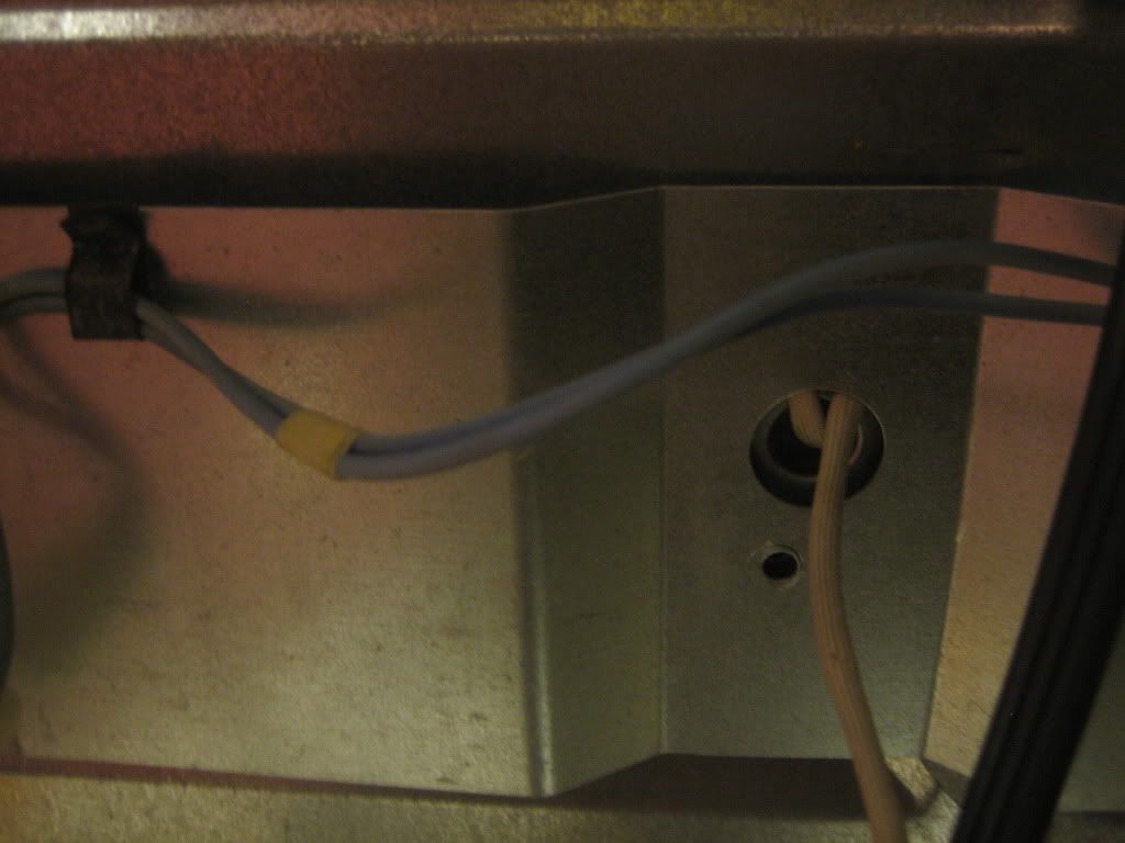

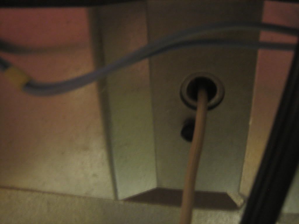

Here is the odd part.  The wires were folded in half and jammed in behind a flat panel as shown in the first photo below, rather than simply running through the hole as shown in the second photo (the wires were actually folded much more sharply than shown in the first photo).  Of course it has been this way since purchased new, so I'm not sure this would cause the problem now.  But, since Sears wants $75 for the sensor, I reinstalled it correctly and I'll wait to see if the kinked wires were causing a problem.
