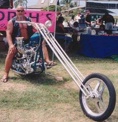

These arrrr my idea of 'stacks'. Perhaps viking stacks is a better term. Haven't been able to find anybody who builds them. The rider used to live in my apartment building however due to his age now rides the other type of two wheeler. Still rolling along though.
