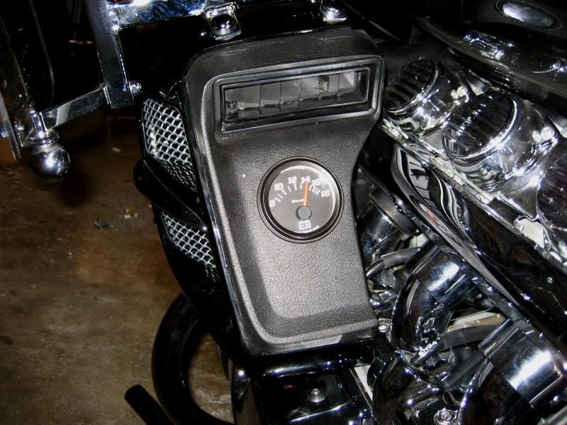

In the future, you may want to keep an eye on things.  All you need is a 2" hole saw to install, and a wire to your accessory lead.
$23 at J C Whitney and they also sell a matching water temp gauge that can be put in the other pod.

While I was waiting for the rebuilt unit to arrive, I installed a voltmeter just like you suggested.  In fact I put it in the same location you did and hooked it up to the accessory lead.  Scary similar thinking.  cooldude
