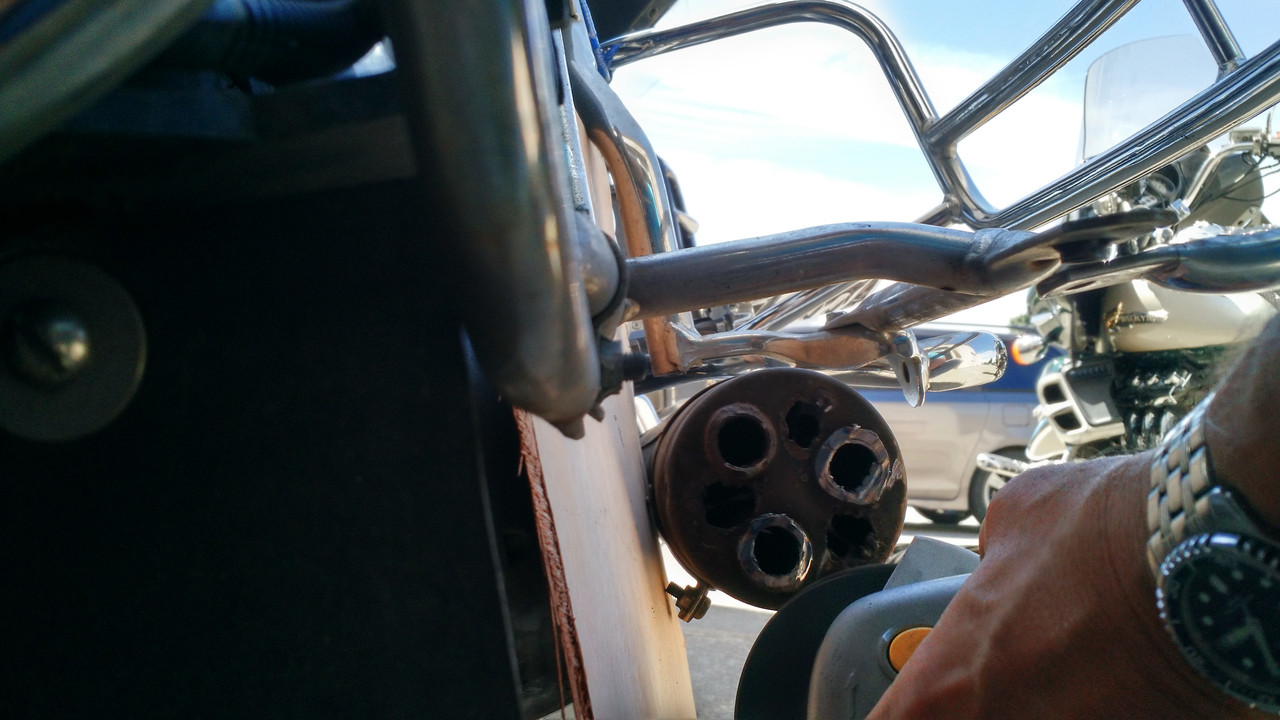

Paul grinding away on the end of the muffler, leveling the surface to apply the piggy plate onto.
notice the holes in the muffler too?
Don't forget to cover the whole bike with a bed sheet or something. We had debris everywhere.
We used a small pilot drill to mark the location for A screw location. Then drilled it out larger on the plate, and drove the screw in to hold the plate. Then while it was in position, drilled the other 3 (in our case) pilot holes, 1 at a time, and again, enlarged the plate hole, then drove the screws in. Removed the screws and the dowels, applied the cement, and screwed it back on. Followed the directions on curing. Then move on to the other muffler.
In Canada, we used Kleen-flo Muffler Cement. No fiber in it. It crusted over very quickly, like icing does. 1 5 oz tube, and had some left over.
