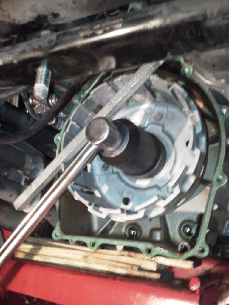

looks like the spacers started cutting into the basket. Did you clean up your basket and reinstall or put in a different basket? I dont see the cut marks in the clean one.

I cleaned up the old one and re-installed it. Waiting on parts Now

When I pulled the basket out I saw the Scratch in the basket. After I cleaned up the basket it looked good to me. all the clutch disk were under the 3.5mm wear limit, and the spring was also low at 4.8 mm.
I,m replacing all the clutch disks, spacer plate and the spring.
