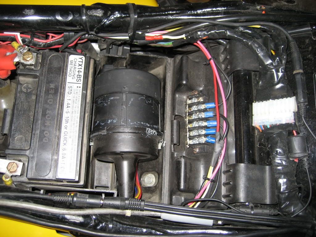

« Reply #4 on: May 16, 2009, 06:06:59 AM »
You can put it here
 or here

Thanks all for the replies. I am going to try the setup without the vacuum canister. I purchased two check valves and intend to T them together with a single line to the servo. I have searched but cannot find an alternate location for the servo besides behind the battery box. I do have a Tourer so behind the fairing aint gonna work. Are the any other other options?

« Reply #9 on: May 16, 2009, 05:09:02 PM »
The vacuum canister from my McCruise CC is in _front_ of the battery in the space under the metal support.

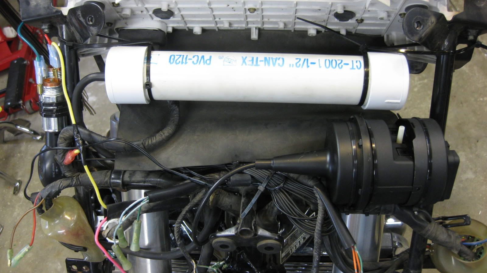

« Reply #11 on: May 21, 2009, 03:34:50 AM »
I mounted the vac canister on my tourer down under the swingarm with a chrome coil mount for an old chevy the 1 1/2 PVC pipe fit perfect and it added more bling.
