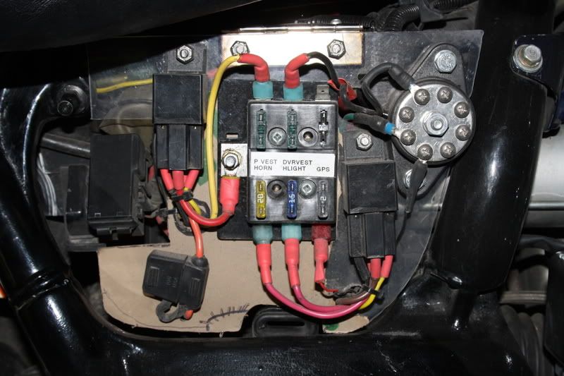

fudgie, what motorider said.
I bought my block from the boat supply store here in town.
1st one was for the Valkyrie, the last one was for the Trike.  Had to do some rewiring under the dash......
The Trike I use a 16 blade fuse panel and a place for 4 relays.  Worked slick for the Trike.........   Now as we play with a circuit or one gives us trouble, we just add another relay and run wires to it.
Last addition was a air compressor replacement for the Air Horns.    The old compressor took about 6 minutes to fill the tank from dead empty.   This compressor will cut off, using the same pressure switch as before in 1 minute and 5 seconds...
I think I did some overkill, but it sure sounds good back there when it pumps..........  At least I know I got a horn this way.....

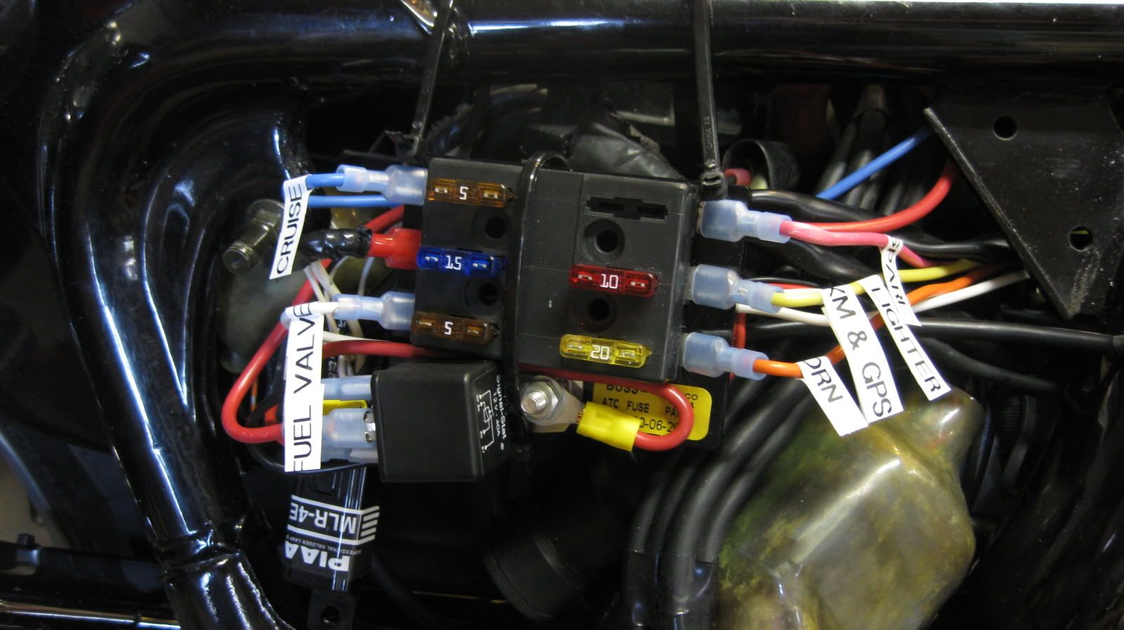

I use eastern beaver for bullet connectors and his new panel is very nice but it is a low load panel-(edit: early stats had it being only 40 amps total its now 60).  I use an 8 ganged fused panel for a higher load rating with a separate ground block. The photo below is a 6 gang but I had to upgrade for a trailer.
If from scratch I would choose the 6 or 8 ganged fuse panel with ground block included from wiringproducts.com
http://www.wiringproducts.com/index1.html
Hope this helps Chris
