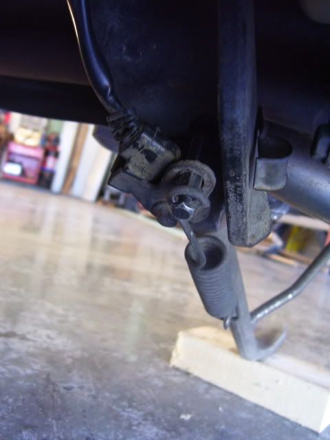

Did you try quarters in the spring ? Mine has one spring.
Look at the picture the long end goes to the bolt for switch clearance.

I have this in my Photo stash and a similar picture is in Shoptalk Microfiche.
Sorry bobm you already posted the same picture.
« Last Edit: March 09, 2012, 04:46:02 PM by Bone » Logged
