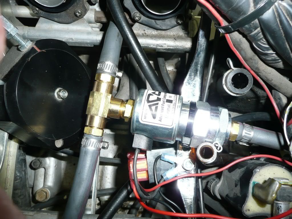

« Reply #10 on: February 16, 2013, 06:27:27 PM »
Thanks for this thread guys. With the info here, I was able to get my new dan-marc installed successfully.
I went with the simpler model, which does not include the magnetic particle/fuel filter. Also I was unable to find the brass fittings needed at my local hardware store to build the T. Instead, I just put a brass male hose barb on each side of the valve. Trimmed the fuel line appropriately, and installed a relay using the same method as pharmboy. For the relay's "signal-on" wire I used the black and white wire on top of one of my coils. Works great. I used blue permatex for thread sealant.
Here's a birdseye view. Thanks again.
