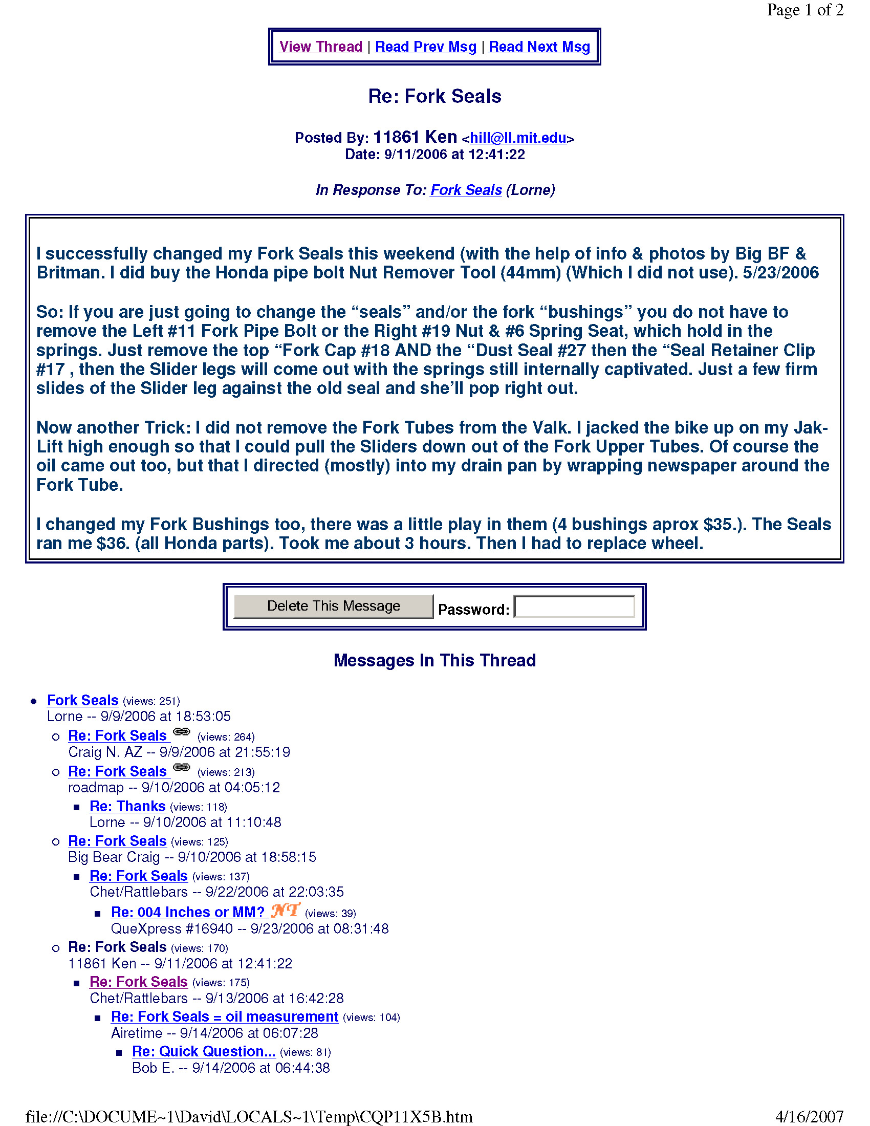

It still isn't a big deal to replace the seal.  I've done it with the fork on the bike following a method Chet (Rattlebars.com) posted several years ago.  Only takes about 2 hours.  I've got a PDF with the instructions on a different PC.

I have a Word doc for changing the fork seals. No special tools as you don't have to remove the springs.
E-mail me at fallistonATgmail.com if you would like me to send you the file.

Here's the old post on the east method...
