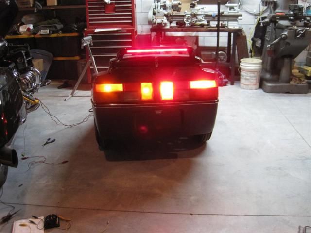

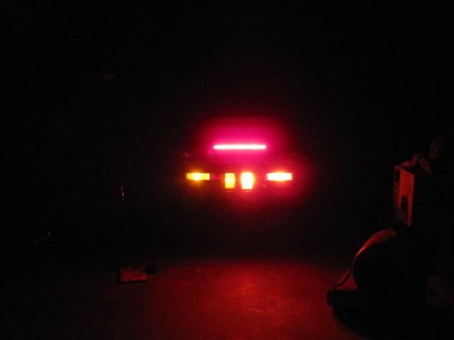

Here is the brake light in MGM, don't have a picture of the LED's in my trailer.  Both are attention getters when applied.
This is the replacement innards from Radiantz.
http://www.radiantz.com/
Click on taillights, then click Honda and it should appear.    Couldn't get the link to take us there from here.
I used the one on the right, had to trim a notch off.    These B*stard's will get your attention when applied.
Look at the reflection in the tractor seat, this is in a fully lighted shop.   In fact there is 4 tube florescent right above the bike.
