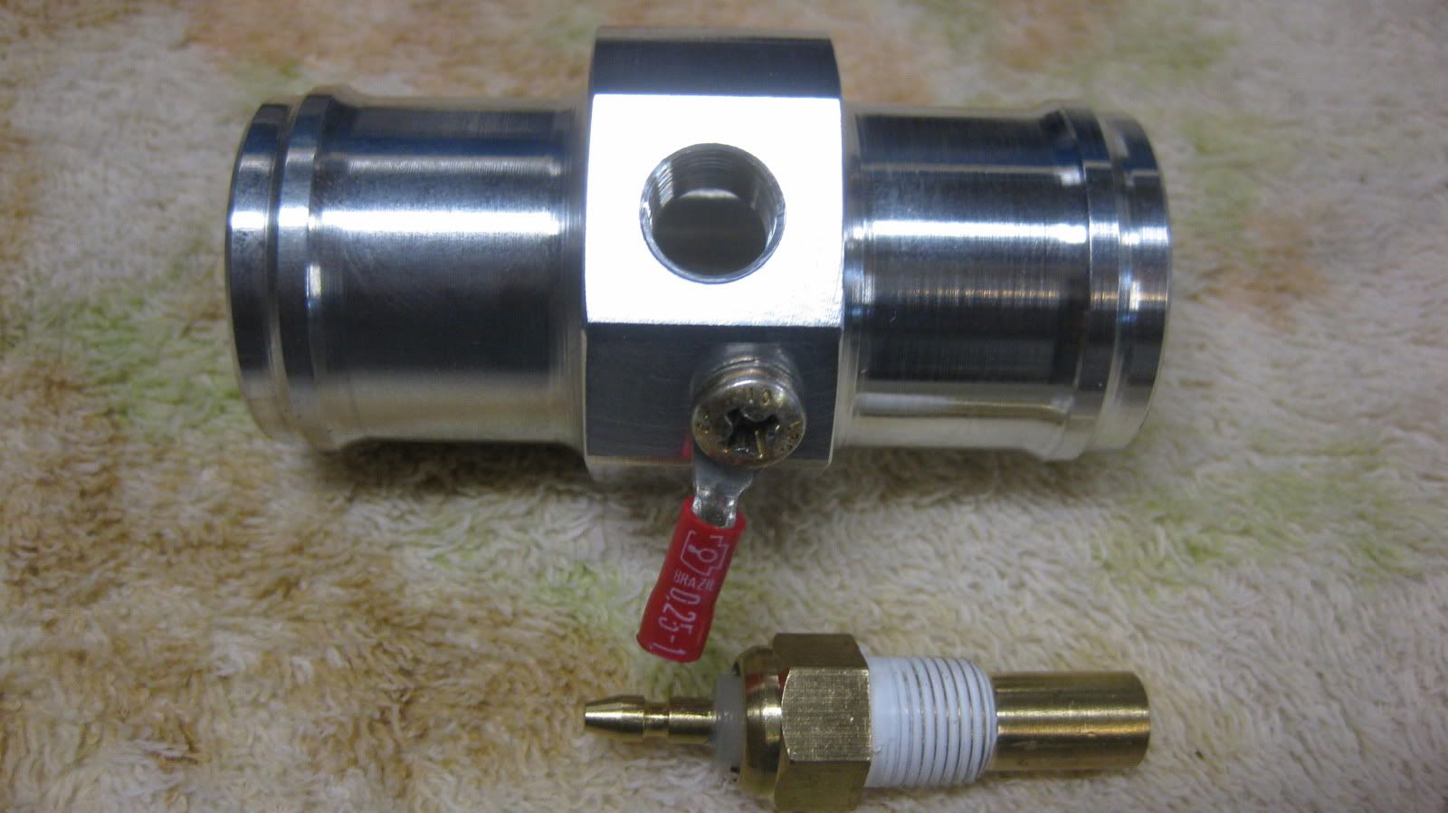

An adapter like this should work fine
http://www.glowshiftdirect.com/28-mm-water-sender-attachment.aspx
I did my original installation on the underside of the block.  Getting that sucker in there was a batch, and the readings were, well, not what I wanted.
I felt the radiator hose location was easier to do, and a whole lot more accurate.

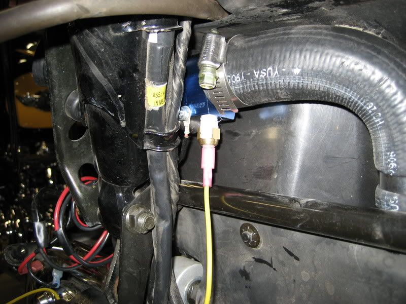

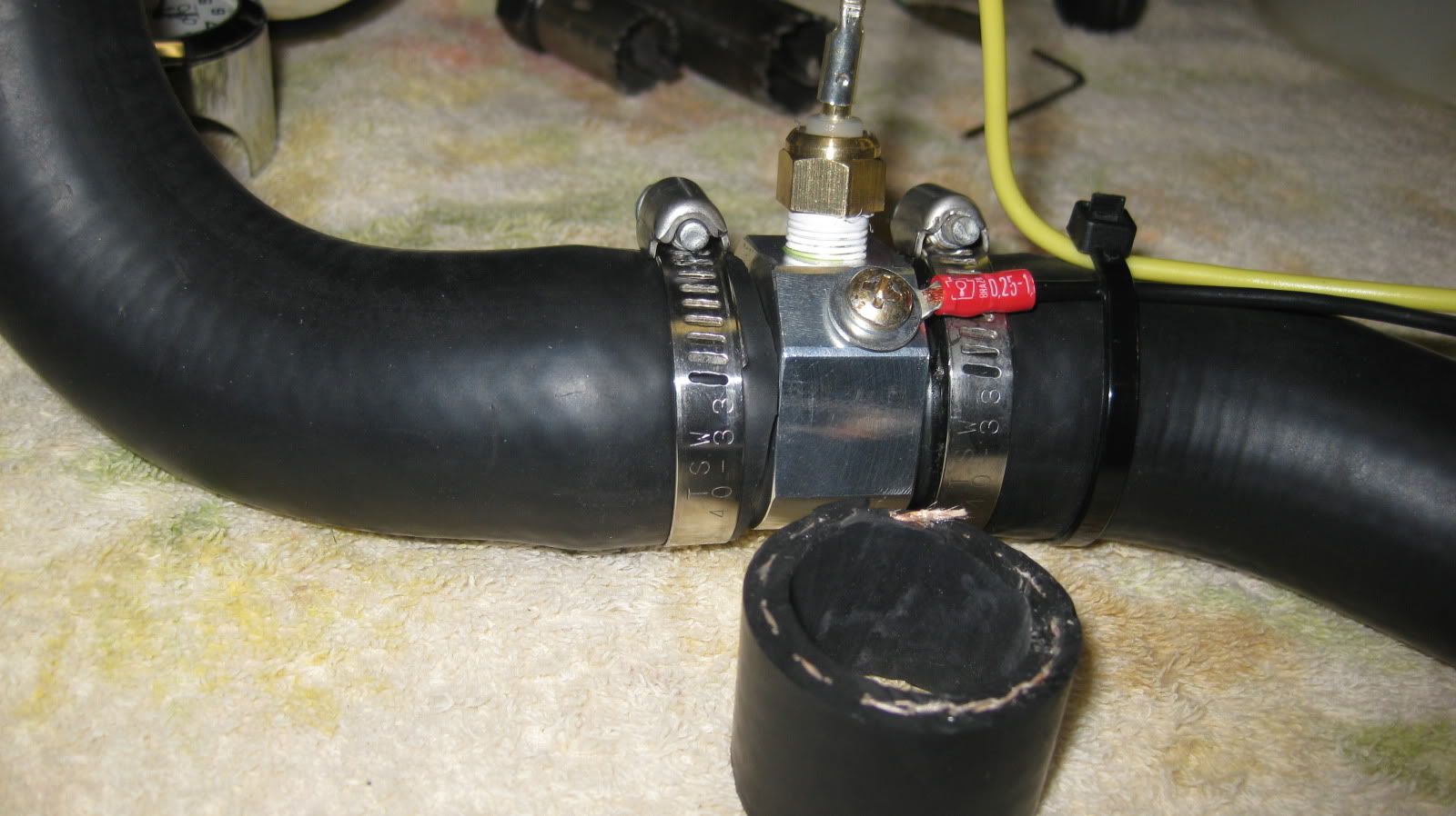

« Reply #14 on: May 20, 2009, 07:24:11 PM »
Coincidentally enough, I just installed a temp gauge sensor today, in the upper radiator hose. I got my adapter from our member RP#62, who you can send a PM to, to see if he has any more.
Here's the adapter, with the sensor for my gauge.
After you've determined the adapter location in the hose, don't forget to remove an amount of hose equal to the amount of length the adapter takes up.
