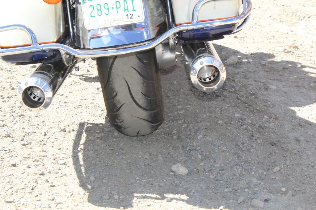

In preparation for some long trips this summer I switched to my stock pipes to reduce noise and allow me to use my bluetooth headset without blowing out my ears. The only problem is I can't stand the stock look! I decided on a set of Grumpys tips and stack extensions. Unfortunately AirFlo was out of the 18" extensions until June but had 38 and 40" stacks available. So thanks to the advice of a couple of members, I purchased a 40" stack (it was cheaper) and cut it in half. So now I have 2 20" extensions with Grumpys tips  cooldude. All good, or so I thought. The sound was terrific but the droning at highway speeds was unbearable and the whole idea was to be able to use my bluetooth headset in the first place! So after doing some research and looking online, I came up with these 4" slip in silencers.
I figured they couldn't possibly restrict the stock exhaust more than the 3 3/4" piggies already do  Grin. Here is the installation.
So now I am very happy with the outcome. The sound is still very nice, better than stock, but the droning is gone  cooldude. I took a short trip up the mountain to test them out and stopped at an old gold mine. I am undecided on whether the 20" extensions are too long or not Grin. I can always cut them down to 18".

Chillerman
Posts: 689
Golden, CO
« Reply #3 on: April 01, 2012, 07:24:43 AM »
I think they look great. cooldude
Thanks Mac!
i always cut my stacks to where they were about 1 inch past the rear saddle bag rail...
Yeah, these extend several inches past. My only concern is scraping the ends in tight turns on an incline. Is that an issue?
« Last Edit: April 01, 2012, 08:24:54 AM by Chillerman » Logged

 Shocked   That would be SOME incline ,,, you DO realize these are not "off-road" all-terrain machines  Wink
The pipes look great  cooldude

Chillerman
Posts: 689
Golden, CO
« Reply #8 on: April 01, 2012, 09:40:26 AM »
Not chillerman but the website link is
http://shopping.rexmar.com/Merchant2/merchant.mvc?Screen=CTGY&Category_Code=silencers-inline-insert
In case the link goes bad, its rex marine http://shopping.remar.com search for silencers.
That's the one! Thanks chrise2469  cooldude. Had them in less than a week.
The stacks are from here http://store.airflo.com/chrome-exhaust.html
And the tips http://grumpyscustomparts.com/
EDIT: One note, the silencers are 5" long. If your piggies are stock length, the shortest you can go on the extensions is 17 or 18".
« Last Edit: April 01, 2012, 06:48:01 PM by Chillerman » Logged

Chillerman
Posts: 689
Golden, CO
« Reply #12 on: April 01, 2012, 03:54:23 PM »
These look like pretty restictive baffles so how much hp are they sucking up?
The tips do look nice tho........  Let me know after a long trip if you feel like you lost any power.
Any other testimonies?
thx
jpw
I took a 60 mile ride today. I haven't noticed any loss in power. The three piggies coming out of the stock exhaust are only 3/4" each, the total opening in these silencers are much greater than the piggies so I don't think they are restricting anything to tell you the truth. They are just redirecting the flow, that may in itself raise the back pressure a bit, but the website says they are good for relatively stock engines up to 500ci! I'd say they are ok for our little engine.
« Last Edit: April 01, 2012, 04:00:13 PM by Chillerman » Logged

Chillerman
Posts: 689
Golden, CO
« Reply #16 on: April 01, 2012, 05:29:53 PM »
chillerman.......
How heavey are these "Slip-in Insert Silencers".  Do they weight much?
The box they came in said 3lbs on the shipping label, so they weigh less than 1 1/2lbs each.
is that the price for each..or are they sold as a pair..
They come as a pair for $78.95.
For anyone considering doing this, I have put over 150 miles in the last two days from 6000ft to 10000ft with no issues. Pulled up the mountain in 5th just fine. Gas mileage the same on that tank. My ears feel good  Grin. I would recommend placing them as near the end of the tailpipe as possible to avoid sound waves bouncing around in that 4" pipe.

Chillerman
Posts: 689
Golden, CO
« Reply #20 on: April 01, 2012, 06:31:27 PM »
Chillerman....
What kind of helmet do you ride with if you don't mind me asking.  I can ride most all day with my half helmet on, but with a full or 3/4, the drone used to get pretty bad.
Yeah, I have three full face and a modular. I know the helmets are likely adding to the drone, but I don't want to go to a half helmet. I have audio set up in my helmets the way I like it now.

Chillerman
Posts: 689
Golden, CO
« Reply #24 on: April 01, 2012, 06:55:16 PM »
This might be what I'm looking for.  I'd like to be able to wear my full face when I want to instead of being limited strickly to my half like I am now.
I've got the ragnar cut on myValk and I used to have just straight 24" baloney cut extensions on the bike.....and the drone was horrible with a full on.  I've since put on 18" airflow extensions with the same Grumpy's tips that Hoser is running.....and the Grumpy's have reduce the drone somewhat.  It must be because the Grumpys upset that airflow some.
I have a pair of silencers from MarkT that I wanted to try, but haven't yet.  Mainly because I was concerned of the added weight of the silencers.  I wanted to put them on as close to the end of the exhaust as possible.  I've only got two bolts holding each 18" tip on the bike now because of the ragnar cut.  With the weight of the Grumpys and with the added weight of the silencers, I was concerned about all that weight hanging off at the end of the pipe with only two bolts holding it all on, level and straight.
Thanks of the tip chillerman.....I'm gonna give this a try and see what happens.
Let us know how it goes. I only have two bolts holding my extensions in as well and mine are straight. I wanted to keep them hidden. I think the can holds most of the weight anyway.
Chillerman
Posts: 689
Golden, CO
« Reply #25 on: April 01, 2012, 06:58:39 PM »
It can be, and I'll tell you where...... departing a steep gas station (or other) apron and making a hard turn onto the roadway while still on the apron.  I've nicked my 18" straight cuts this way.  Backing down on a curb can also do it, but often while backing up level, you clear the curb, but after shutting down, you lay the left pipe on the curb putting the bike on the side stand.
Thanks for the tip. I worry about pulling out of my driveway into the street because of the drop. I will be careful.

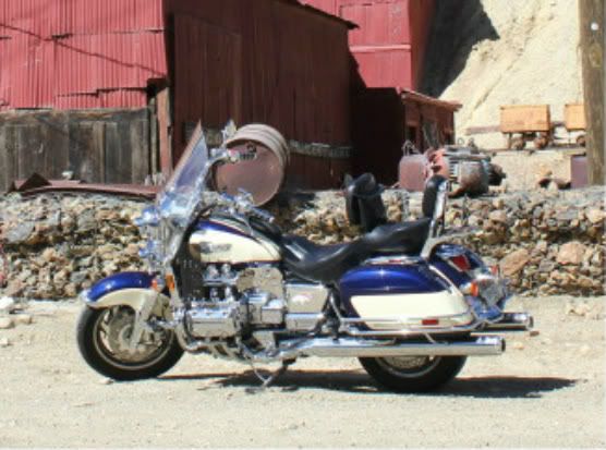

http://www.mustangseats.com/Product/13300/Universal-Studded-Saddlebag-Set
I got them from Cruiser Customizing for right at $700.
They are identical to the Tsukayu "quick release Strong hardbags".
http://www.tsukayu.com/QuickDetachableStrong.html
I don't know for a fact, but I'd bet that Mustang contracts with Tsukayu for the bags and then has their material put on the bag.
I really like them....they're a very nice bag....lined and with good locks/hardware.
The trunk is a Harley Davidson leather Tour Pak for the Softail Heritage.  It matches the bags perfect.
The back rest on the trunk is from Corbin.

How close was the sound to the original OEM sound with all piggies in?  If indicated, use a Goldwing as a benchmark.  I have OEM pipes without the piggies and your are right, the drone sound when on a long ride is not to be enjoyed.  Have noticed any diffence in power?
« Reply #33 on: July 31, 2012, 03:08:18 PM »
No loss in power.
What's been done to your oem pipes?  Just cutting the pigs off will not make it any louder......just a deeper tone, but not louder.  If your pipes are louder than a set of unmolsted oem pipes, then odds are, they've also had the rear baffles drilled out too.  Take one of your tips off and shine a light in the can to see what you've actually got there.
Keep in mind that my pipes have gone beyond cutting the piggies AND drilling out the baffles.  They've had the ragnar cut done to them.....basically gutting the entire rear of the exhaust can.....thus making it much much louder than a set that's just had the piggies cut and the baffles drilled out.
My pipes with the piggies cut and baffles drilled....
Honda Valkyrie - LED turn and tag light modificationspowered by Aeva
After Ragnar cut...
Honda Valkyrie - after Ragnar Cutpowered by Aeva
After installing the slip-in silencers, my pipes are now quiter than when they had the piggies cut with baffles drilled.  It's still not Goldwing quite......it still has a nice little growl to them without being obnoxious, but it alot quiter than it was.  I'd say it's a little quiter than it was with the piggies cut and with baffles drilled out.
I like it.....it's not loud at all, still has some growl (I can actually hear birds chirping on the side of the road now like I could when they were in stock form) and best of all.....no more drone.
I can't promise, but I'd bet that if you've got cut pigs and drilled baffles.....and if you install a set of the slip-in's, your pipes will be very close to the original oem sound of your pipes.
Besides......if you don't like them after installing them, you can simply remove them without having to use a cutting torch or a hacksaw.  Just unbolt them and take them out.
