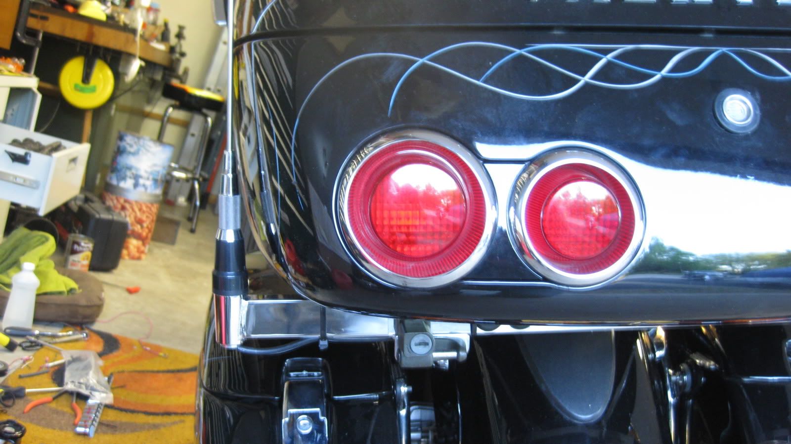

The cb's come up for sale occasionally, but the antenna isn't always included.  I haven't been able to find new antennas, or especially mounts.
Thanks to a tip from DFragn on the mount, and a little luck on the antenna, I've found a very acceptable solution.
The mount requires some sawing, Dremeling and drilling (screw hole) but then fits perfectly.  The antenna fits the mount just fine with no modification.
The mount puts the antenna in a backward lean, but not quite as much as the Valk.  A simple slight bend at the base of the antenna matches them up.  And, of course, the antenna folds just like the OEM.
All in all, it's a pretty good substitute

Kingbee, I broke my CB antenna off near the base the other day.  Do you think the antenna you purchased would fit the stock IS mount?   Maybe I would have to drill and dremel a bit, but I am up to that task.  I just can't find one on-line.

I think that antenna should fit without alteration.  The coax is longer, that's all.
