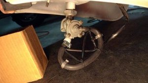

The quick disconnect itself flows in a loop:
« Last Edit: April 08, 2012, 05:25:50 PM by BonS » Logged

Just looking at the picture from Redeye's website I can see two places, just above the fuel line clamps, where the line is kinking. Now that can't be good for fuel flow! I can believe that it might be some other issue like this rather than a simple dip in the fuel line.
My supercharged Valk has a Pingel that has its fuel nipple pointing down. This results in a fuel line that loops down and then rises up to the single carburetor. No problem at all.

Ive had them on both my Valks for a few years now with no problems and they certainly improve fuel tank removal.
Posts: 10651
« Reply #15 on: April 09, 2012, 02:15:56 PM »
I would like to see this pic a tad larger please.  Evil
