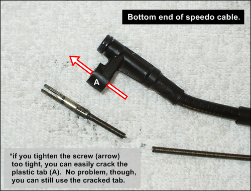

« Reply #4 on: April 10, 2012, 12:30:17 PM »
all that's needed to inspect the internal cable is to remove phillips screw at the speedo housing on the axle. The cable falls out by itself from the sheathing. Actually slitters on the floor and picks up grit. To reattach the cable to the speedometer you'll have to loosen the nut under the meter so you can position the tang at the top end of the cable properly. With the internal cable disconnected at the lower end you'll be able to manually rotate the tang that turns the nylon gears in the lower speedo housing unit to see if they operate smoothly, it's a worm gear arrangement.

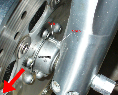

« Reply #5 on: April 10, 2012, 01:14:34 PM »
Also look to see if the wheel apparatus is in the right position. Have you had the front wheel off lately? Start there and see what happens
should look like this ....

The Speedo Drive is the same between all Valk models. The I/S models have an "analog to digital" transducer attached to the drive unit and no "cable in sheath", however they do have an digital cable that sends a signal to the dash mounted readout.
I've seen speedo drives fail as well as cables. If the cable checks out, replace the drive at the wheel/axel interface. And yes, don't overtighten the cable mounting screw at the drive unit.
