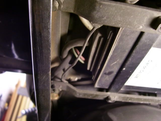

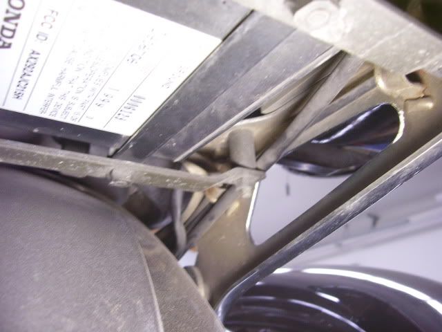

« Reply #3 on: April 12, 2012, 05:42:31 PM »
Ok. Here is what I found.
You might already know some of this if you have your trunk off.
The longer brackets with the little step in them are 9 11/16" long, from the bolt holes, center to center. They are about 1/8" thick and 5/8" wide. The little steps are about 1/2 " total outside to outside.  The spacers they they mount to the chrome rails with are 1" tall. It looks like the steps are there to clear the chrome rails toward the back where they taper down.
The u-shaped brackets that hold the CB to the long brackets are 5 1/8" long from the bolt holes, center to center. The u-shape is 1 1/2" deep. And they are 1/8" thick and1/2" wide.
I think you are going to have to modify the measurements though, because the CB is 6" long (not including the wires) x 4 1/2" wide and 1 1/2" thick. But the radio is 5 1/2" long( not inc the wires) x 5 9/16" wide and 1 3/8" thick.
Plus I don't  know how you are going to lengthen the 9 wires that go to the radio!!!
Here are a couple pics.
John

« Reply #4 on: April 12, 2012, 05:46:11 PM »
Thanks for the replys.
I downloaded the IS installation manual from Valkyrie Norway, shows nice pictures of how it is mounted, and what the hardware looks like. Not having a CB, I'm not sure of the size compared to my stereo, but I'm fairly sure that the CB and the IS radio (which I still have from my wrecked IS) are the same size, since it fits under the seat in the same place.
Windjammer, that plexi glass, how thick was it, I take it that it was a square sheet? Might be the easiest, and no rusting. I'm wondering about heat build up on the stereo, but there is a heat sink on the end of it.
Those pictures make more sense, I thought the cross bracket when on top of the radio, not between the 2 supports.
