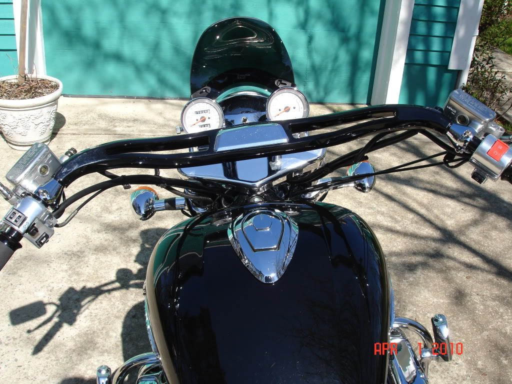

I was looking for something a bit different too...  I read on Tim Skeltons' site about the variety of bars offered by 'Wild1' (http://www.wild1inc.com/), and went that route.  They make what is called a 'Chubby' bar - A 1 1/4" bar, necked down to 1" where needed (controls & clamp).  If you want, the bars are drilled, to facilitate running the wires inside the bars.
I chose the WO518RK style (made for the Road King).  The reach is slightly lower, a bit wider, and a bit closer to me, than the stock bars.  Also, they have a 'blem' section of their site...  I purchased a blem (saved some $$$), and they had to point out the blemish, otherwise I never would have found it.
Here is my view of the bars...
Another look...
Just one idea of many you will probably get  Wink  If you make the switch, post up some pic's for the rest of us to see!

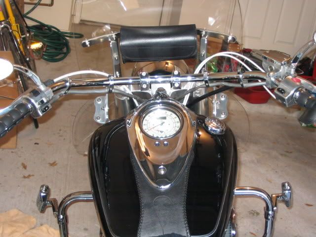

Here is a pic of my 1" Bikini Beach bars I installed on my Road Star. Very, very comfortable and looked great! Notice they are flat all way across. They continue to curve wider to end of bars.
I ran these with pullback risers. I did have to install longer cables with this setup but it was worth it.
So far, I have not seen these on web currently. Pretty sure White Bros made them.
I don't  remember, for sure, the width (widest Point) but think it was 36".
