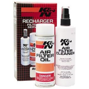

OK, back in Amarillo, I could get my K&N cleaned and recharged for about 20 bucks. Called a PEP boys and he quoted me 50 bucks.  Headed down to O'Riely's to get the 8 buck kit and do it my own damn self.  I just thought I could get it cleaned while I had the tank off and was putting on the new right side control unit.

There should be no dirt on the side facing in.  A little cleaner spray on the top side where the oil is  and GENTLY trickle water from side to side so the dirt slides off in line with the folds.  If water is forced through the filter, then the filter is ruined
Posts: 31080
« Reply #4 on: April 14, 2012, 05:36:36 AM »
I always cleaned my own.  Very easy.  I have their recharger kits, but you can use most any soap and filter oil.  One kit will last many cleans.  Let it dry after a soapy cleaning, and again after oiling.  The directions are simple.

Same here, no prefilter, and use the recharge kit to clean & oil my own.

I also clean and recharge the filter .. With the K&N recharging kit...
I recharge every about every 50 k....
