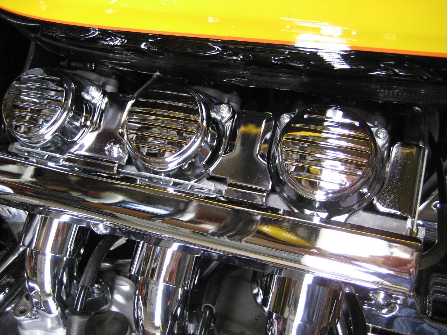

I have also the valance-covers and if these are in place then it is very difficult to get at the rubber nipples to do the carb synchronisation.

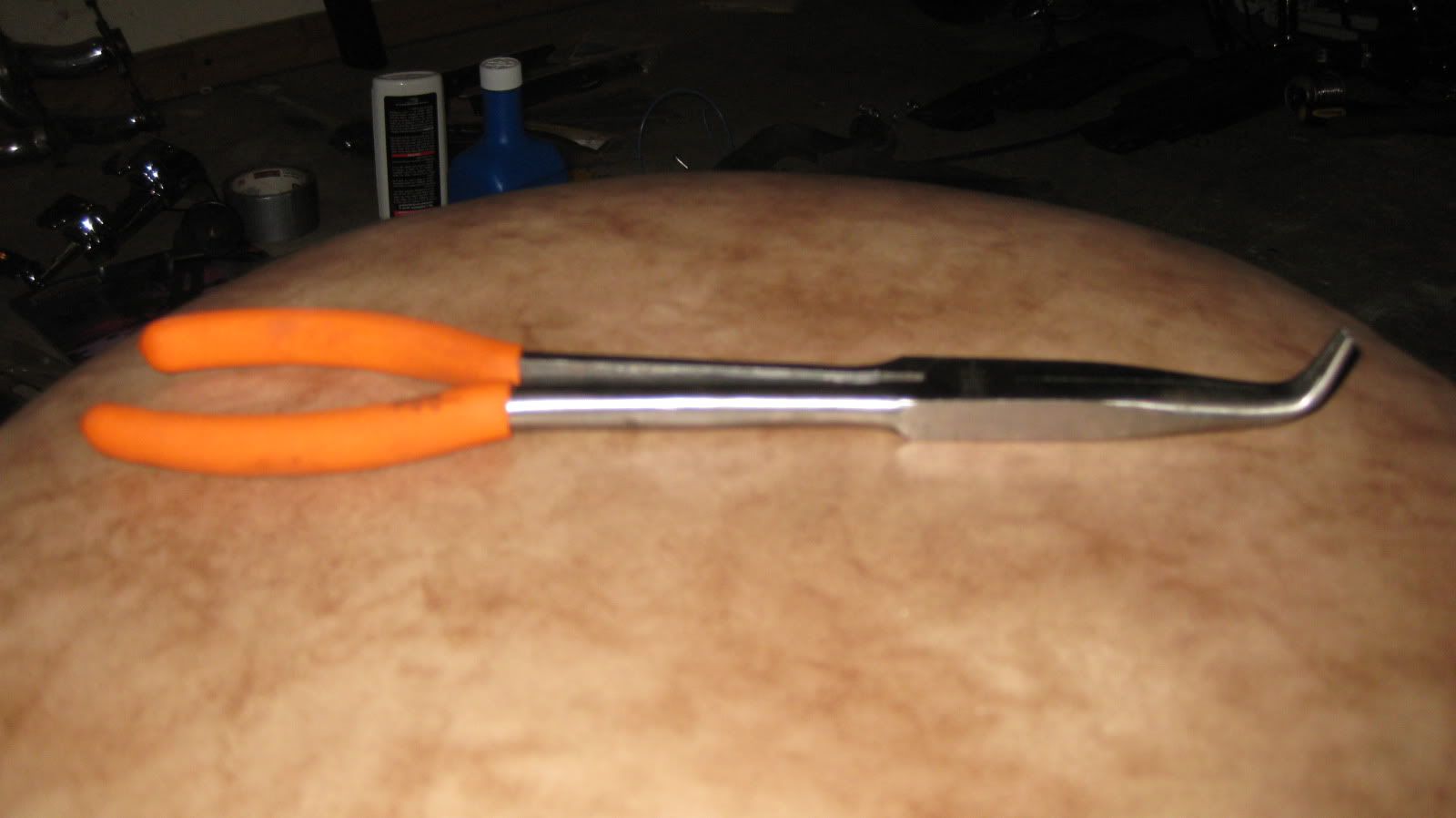

I don't know why the photo is missing, but I have since found a much simpler way to access the vacuum lines, and it works very well with the spark plug valance in place, and is much quicker than un-capping the added auxiliary vacuum lines.

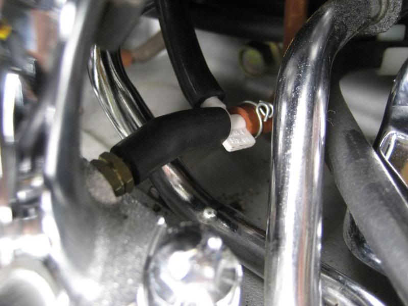

Anyway, here are the original images
Here you can see the added vacuum lines, capped with screws, run up behind the carbs
Once they're tucked behind the choke linkage cover, they're gone
On all my other bikes I use the pliers - much easier.

So if I understad well then the line that goes to the petcock receives the T-piece - what about the 5 others - did you use for those a short piece of tubind + "L"piece 90° + longer piece of tube to end between the carbs, or just 1 piece of tube to end between the carbs ??

You only need a tee on the intakes that already have a vacuum line on them.  Otherwise just remove the plug and run the line behind the carbs.  I'd like to find a better way to cap or plug the lines, though.  The screws can leak around the threads if the head is not tight on the end of the line.  I think something un-threaded would be better.
