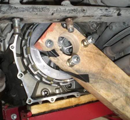

Ok, I made it to the big clutch nut. I saw where F6Dave made a tool to keep the center clutch from turning. Does anyone know how, and what was used to make it? Is he using the 4 threaded holes or the holes in the center clutch?
Worst part so far was getting the kickstand out of the way, and that one bolt on the upper right that's hard to get too. (Kickstand bolts were very rusty and tight)
Any help on how to make the tool will be greatly appreciated!

« Reply #15 on: April 24, 2012, 06:40:57 PM »
Is this what your asking about?
He used a 2x4 and drilled a hole in the center big enough for the socket, then 4 holes lined up so he could install 4 bolts w washers.  Holding the board, he can tourqe the nut (or remove it).   Looks pretty simple to make.
I thought when I did it, I just put the bike in 4th  or 5th gear.  But I could be wrong, it was a while ago.

« Reply #16 on: April 24, 2012, 07:45:21 PM »
Yeah, that's it. I was wondering if the bolts were threaded into the bearing plate holes or if he was using the slots in the center piece. It looks like the slots, but it's hard to tell.

« Reply #18 on: April 26, 2012, 07:58:31 PM »
You're probably finished by now, but in case anyone else is having the clutch rivit problem here's my post from last year:  http://www.valkyrieforum.com/bbs/index.php/topic,30038.0.html
It really is not difficult.  The biggest problem I read about was misalignment of the clutch pack keeping it from fitting in the basket.  The method I used made that part very easy.
