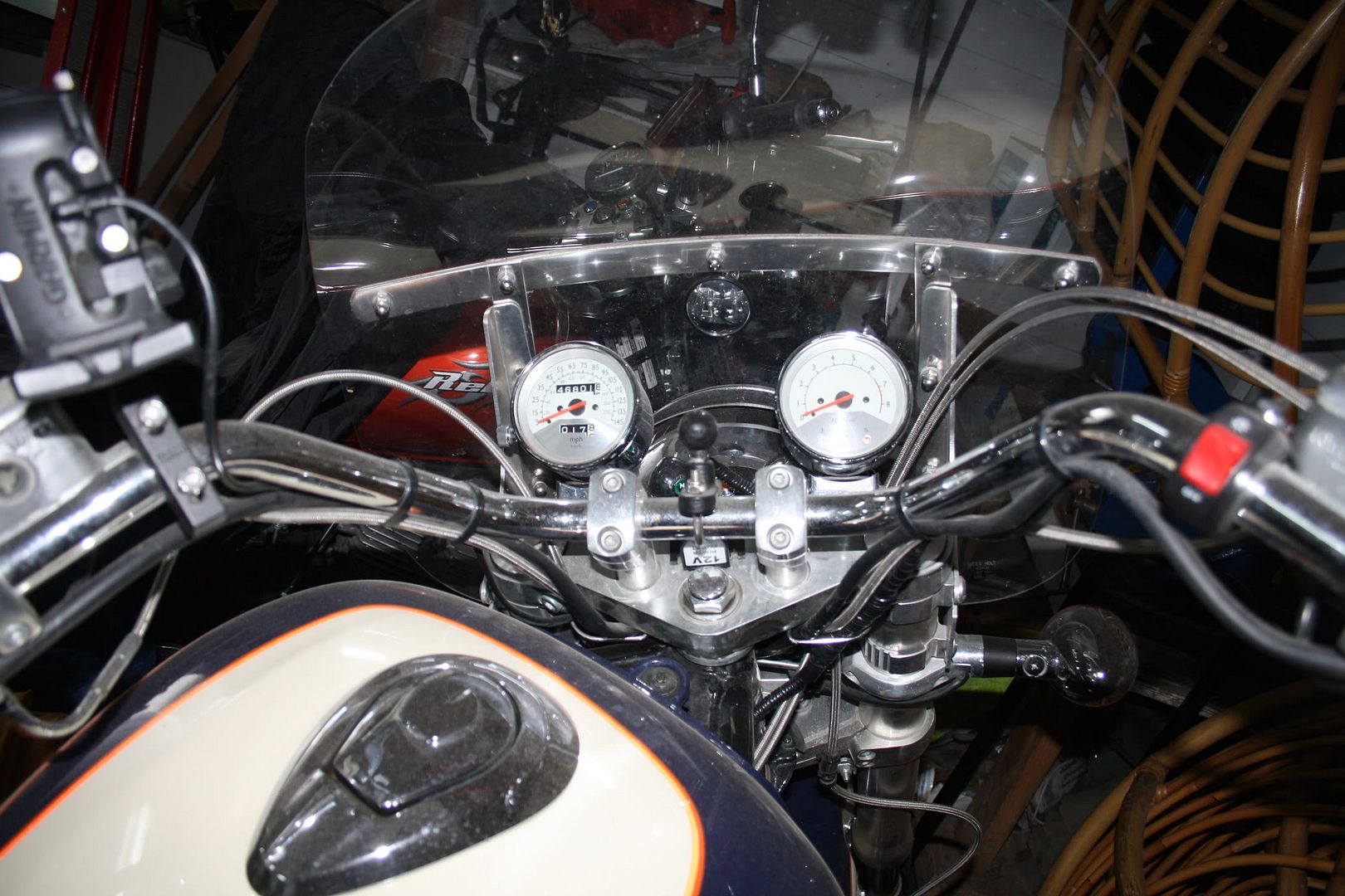

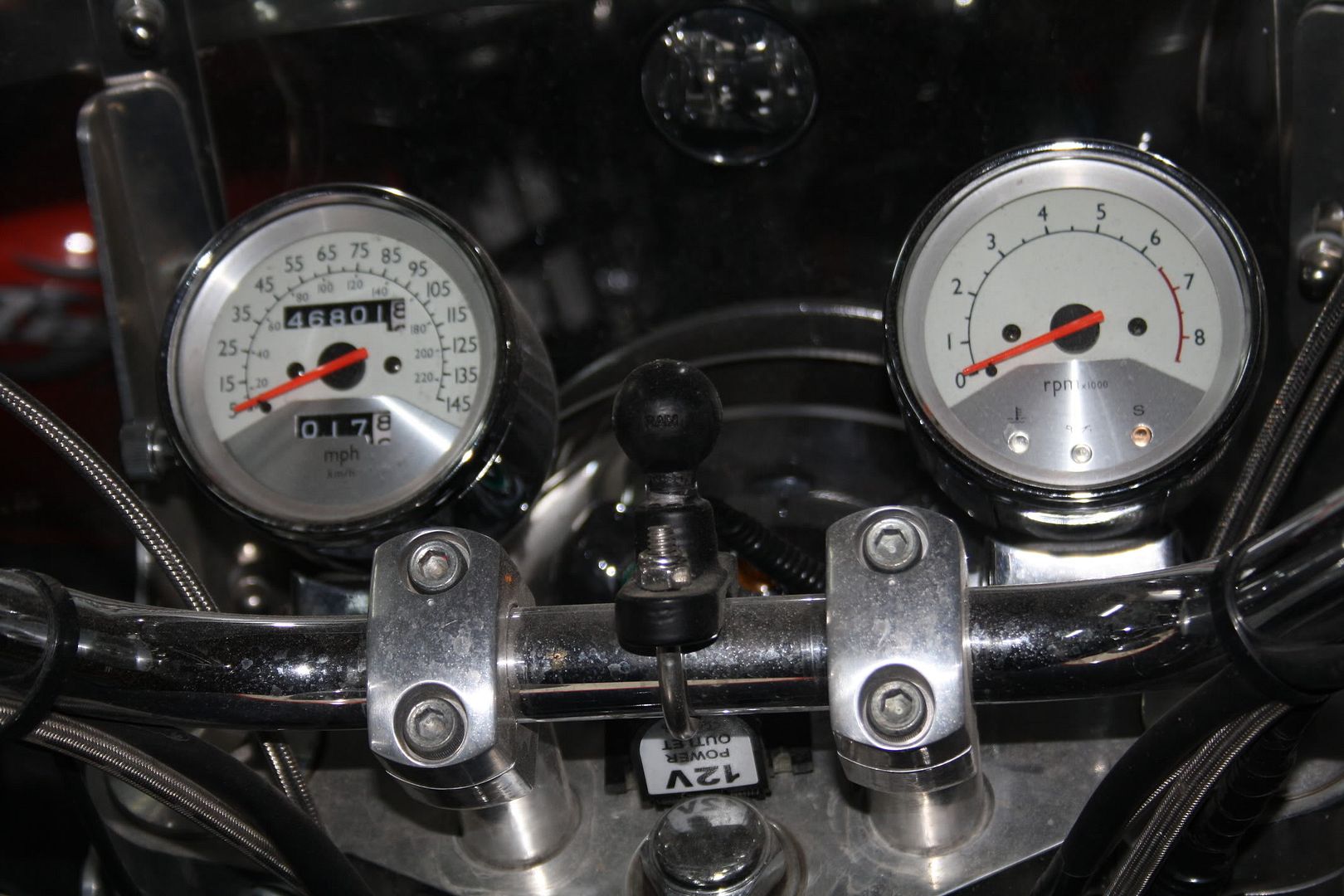

« Reply #4 on: April 24, 2012, 04:22:18 PM »
Can the riser cap be replaces with separate caps without changing the riser it self so the bar between is exposed? A Ram type mount could maybe work in that location if is long or high enough to eliminate the gauges from view.
Yes they can be replaced, honda part 53131-mm8-000  for reference 2005 vtx1300s and several dozen others.  11.32 each at directline and others.
I have a ram mount as you describe, I can snap a photo later if you like.  I will also upload a video taken from that position later- as she who must be obeyed has something for me to do.
The long ram arm puts the camera almost touching the windscreen.
And some interesting lower mounts.

Here's the contour style camera on the center ram mount with the long extension.  I found that the camera must be as close to the windscreen as possible to reduce glare back.

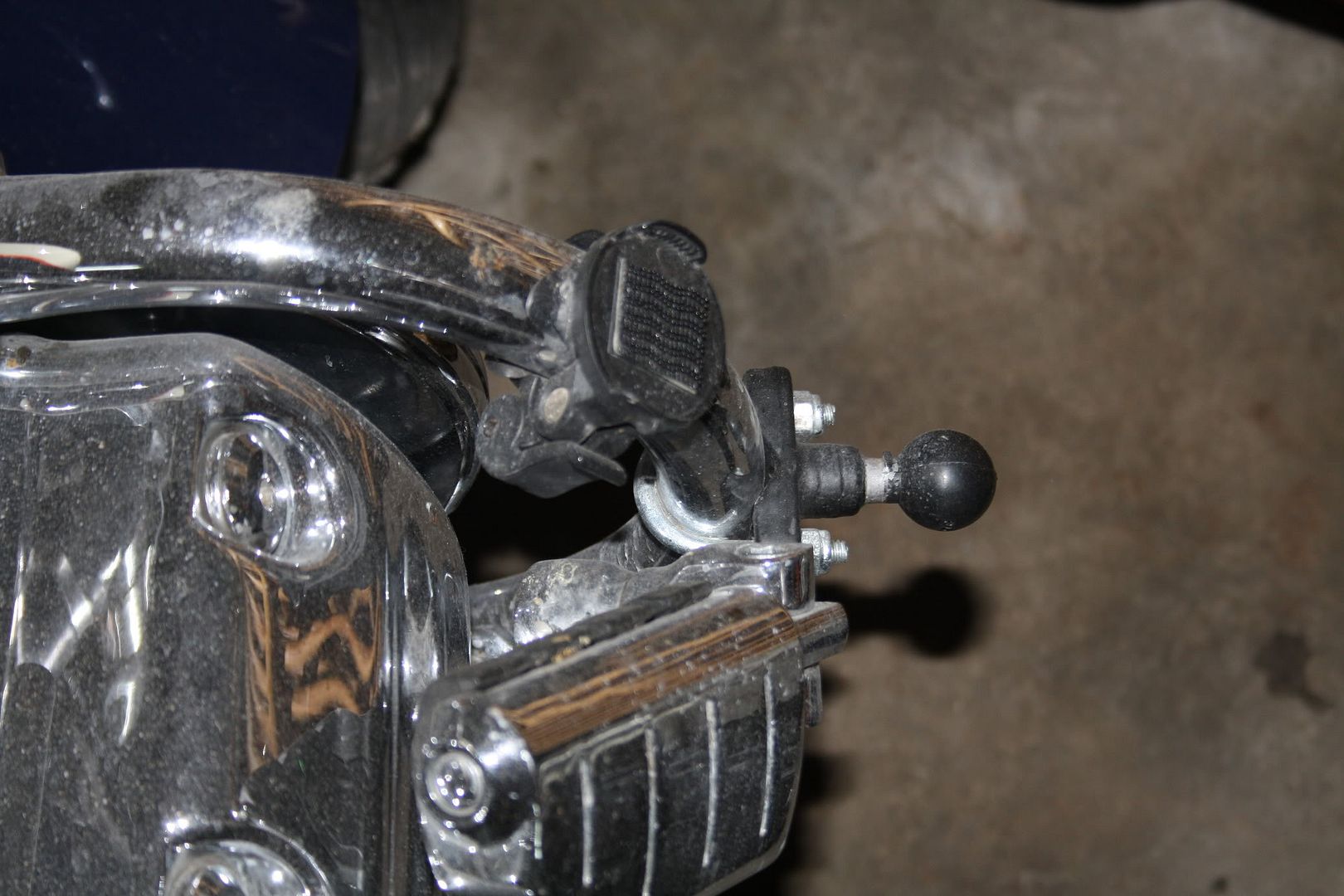

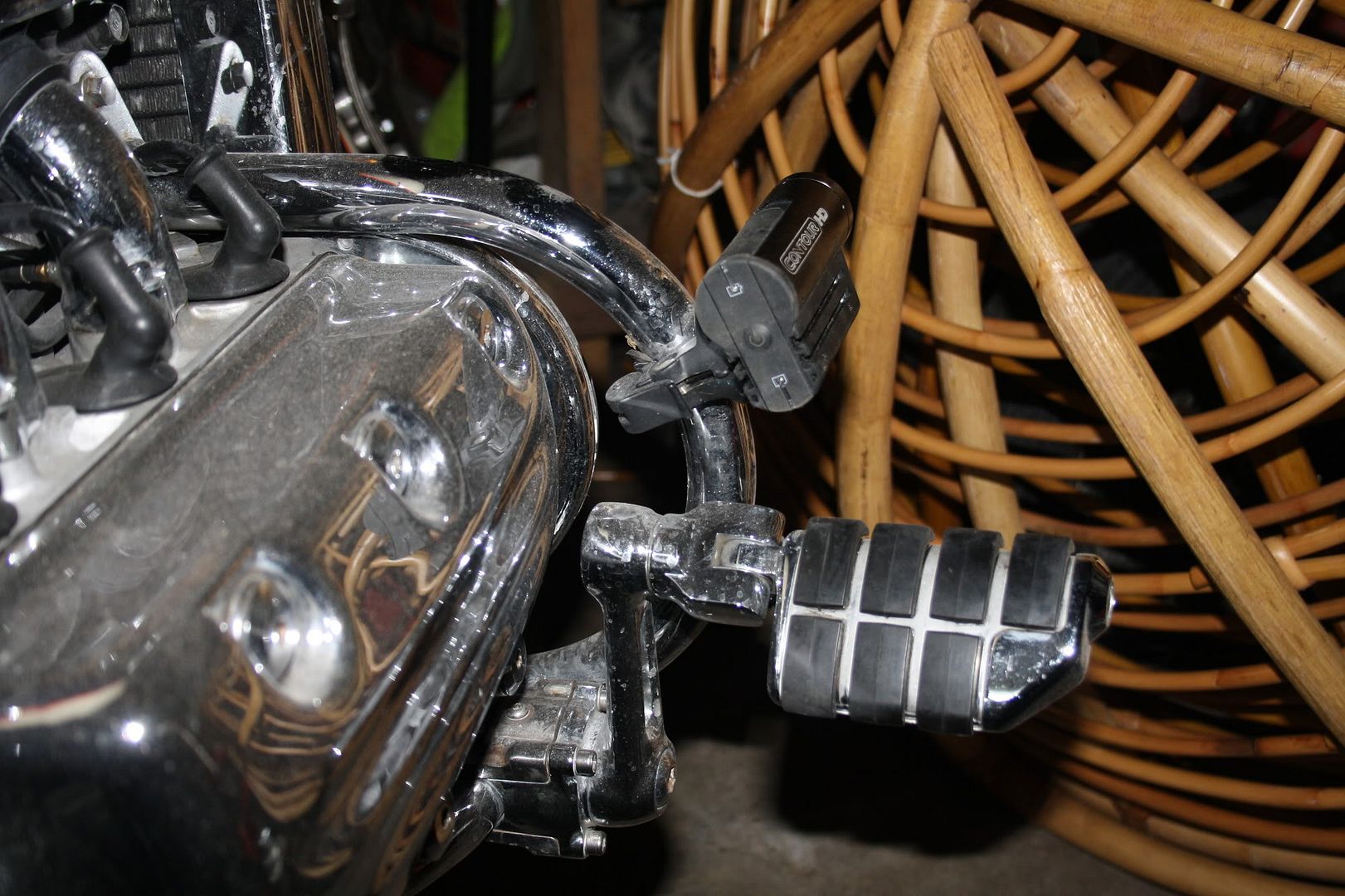

Here are the mounts on the crash bar.

Beauty!  cooldude
I stopped at a GPS place today and that is the mount they recommended. There are various lengths from 5.5"s to 1.5" I believe. The one you have looks like the 5.5" The u-bolt is a bit of an eye sore but is cheap and works well.
With that length I wonder about vibration but when you post your vid that should answer that for me.

Beauty!  cooldude
Good eye.  That is a 6".  If your in Cowtown, GPScity is the place to go, that's where I picked up all my stuff the last time I was there.  Great prices for pick-up.

This video shows the view from the engine guard looking rearward.  This I'd like to see on Smokinjoe-VRCCDS#0005 bike. Actually watch this to the end, its funny. 848x480 59.99 fps

The ram mount behind the windshield is very stable and has little vibration.  While riding I don't notice the helmet shake or buffeting but it is there.
