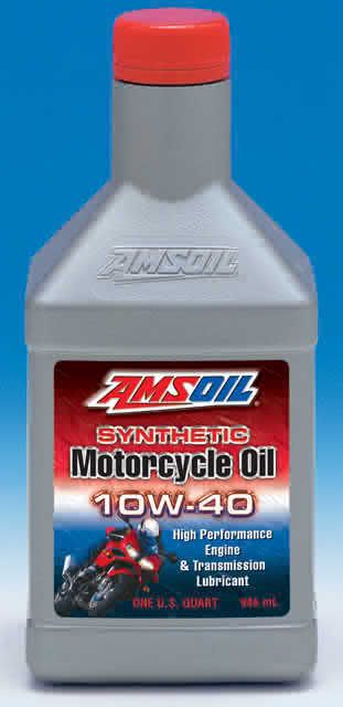

Posts: 6996
« Reply #7 on: May 05, 2012, 02:04:52 PM »
Oil can be a "Touchy" subject around here.
A lot of guys use Mobil 1
A lot of guys use Shell Rotella T
Both are good quality motor oils but neither are specifically formulated for motorcycle use.
Personally I use Amsoil motorcycle oils.
I use 10W40 in the Valk and other water cooled bikes
and
20W50 in the air cooled bikes.
Like I said Mobil 1 and Rotella T are both good motor oils.
Personally I like knowing that I am using a high quality full synthetic oil that is specifically formulated for motorcycle use.
The following link is to a PDF that compares Amsoil motorcycle oil with several other oils:
http://enhancedsyntheticoil.com/docs_Amsoil_Motorcycle_Oil_White_Paper.g2156.pdf
