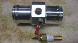

search the tech board, has been addressed before. two ways, re-tap the hole or by and adapter from autometer. I did the adapter first,  temp was off 5-10 degrees due to the sensor not being directly in the coolant flow, so I then tapped it, not difficult. search for the posts that have everything on this.

I installed an Autometer temperature gauge in 2002.  I used the sender that came with the gauge.  I removed the thermostat housing from the bike.  The housing has an existing circular boss on it (shown circled) that can be drilled and tapped 1/8-NPT to accept the sender.  The picture is from Jeff K's site.  The green thing (not the circle) is the OEM temp sender for the ICU.  The temp sender for the indicator light is on the other side:
An old thread, but this is what I've done with almost every Valkyrie I've owned - save the last two. They're using Motosens sensor adapters for the oil pressure and water temp senders.
Gauges have run the gamut from Cyberdyne to Dakota Digital to Auto Meter to Stewart-Warner to JDM. All of their water-temp sensors worked properly (accurately) when inserted into the thermostat housing casting boss.
