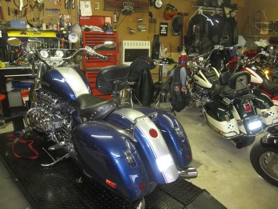

« Reply #11 on: May 12, 2012, 07:36:06 AM »
I also park on my lift - it's the cheap Harbor Freight lift, that can be found on sale in all the motorcycle magazines quite often, for about $289. I did replace the worthless front wheel clamp, with their more substantial chock, with more holes drilled, so it extends past the end of the lift a bit. I used the 20% off on the chock, and it was $50 or so, if I recall. I park on it all the time. I did build some metal "outriggers" so that my feet didn't have to try to fit on the lift, but that was easy-peasy. If you do it, you won't regret it!

I have Direct Pro lift  and park on it all the time.

SpidyJ
Posts: 794
Murrells Inlet
« Reply #18 on: May 13, 2012, 09:52:08 AM »
Geez............Green, Blue Red and Black.............are you single or sumthin'
Can I come live in your garage?   coolsmiley
