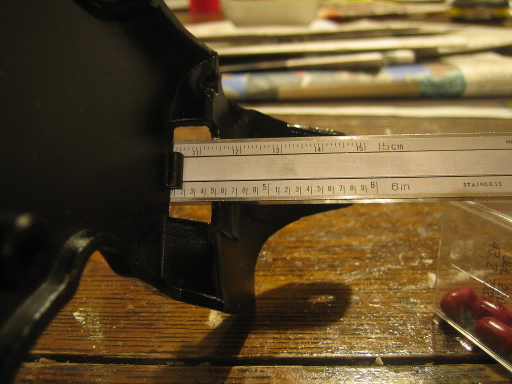

Where the side covers meet the center section towards the front. There is a tab i'm making in my shop to replace the ones that are broken out. Does anyone know how long they are supposed to be?? I took my electronic sliding caliper and measured from surface of the side cover to the back surface of the tab and it averages out at 4.3MM. Thinking of right at a 4MM length. The tab(male part)is with the front center section and the slot(female part)is on the side cover itself. And as usual T I A for any and all help. RIDE SAFE.

old2soon,
I could not figure out where to start measuring, or where to stop.
This is the best photo I could manage:
It would appear to me that the actual depth is not that critical, just so long as there is room enough to insert the slotted part.
IF you want to make an exact replica, I would be happy to ship you my center cover for you to measure, drool over, and otherwise have your way with, in exchange for your promise to return it when you are finished measuring, drooling, etc.  If that is your desire, email me your address and I will ship first thing Monday.  Email to vanagon [four] [zero] at gmail dot com.

old2soon,
  That picture will do nicely thank you very much. coolsmiley The reason i'm making my own tabs to replace the broken ones is right at $195.00. 2funny Appreciate the offer of sending me the center section but i am reawakening old modeling skills from centuries past. uglystupid2 Thanks ever so much for everyones help. Wink When i get these installed and working correctly i'll try to fill people in on it. cooldude So some cop food more caffeine and out to the shop!! cooldude RIDE SAFE.
