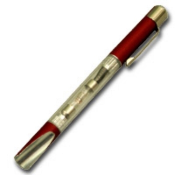

This is one my favorite tools to check for spark. No wire piercing or fooling around with disassembly of any kind. Simply place it on a plug wire and see a neon flash for each pulse. It's easy to see a misfire or no-fire condition. Cheap, portable and fast diagnostic tool. It's a Lisle LIS19380 spark indicator. I've had one in my tool box for over 40 years. It works best out of direct sunlight but you can shade it with your hand. No batteries required. ~$5
You mean it works better then licking your finger tip and sticking it in the spark plug cap??
Well Ill be dammed a fluresent light is you need.
Ill have to try that next time around.
