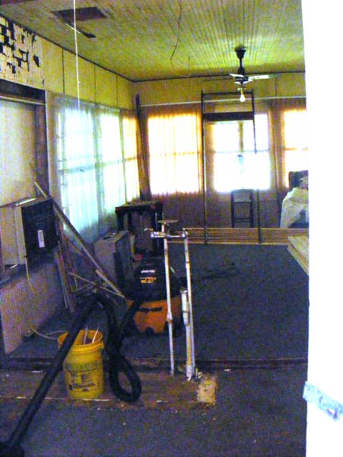

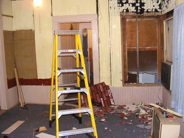

Y'all recall this picture...complete with pepto-bismal color trim?

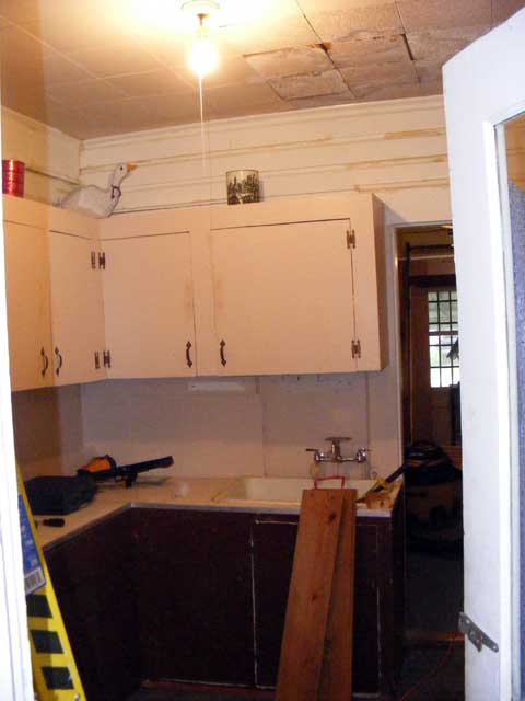

We removed the door on the left...and needed to relocate the door on the right to the center of the space it comes from (our utility room)

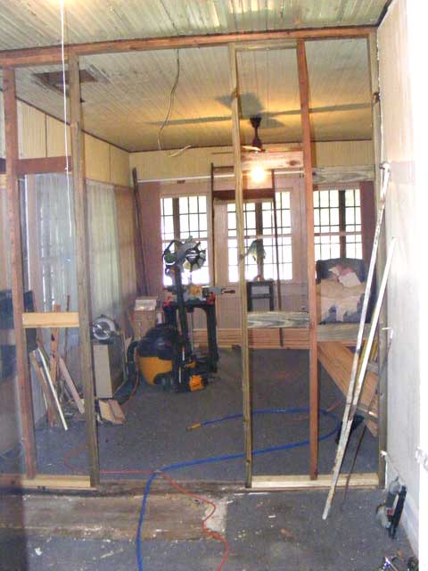

So...wall goes down
Wall goes down

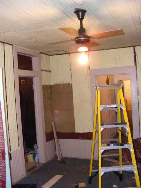

Wall goes back up:
Complete with beadboard...and a door with transom window...centered in the utility room (so we can have cabinetry on both sides of the utility)
