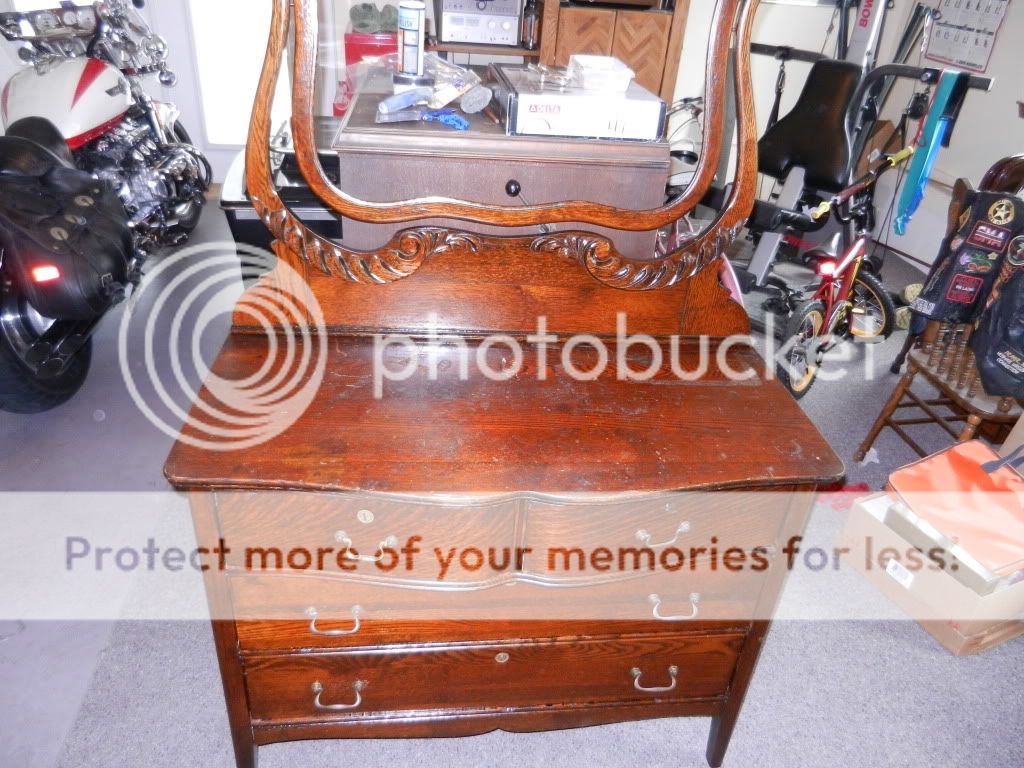

A new customer bought this antique dresser:

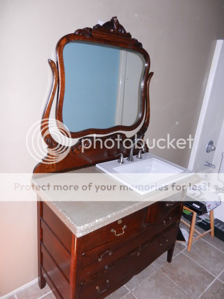

After a bit of modifications and refinishing, a new concrete countertop and a new mirror, it came back to life........I installed this reborn bathroom vanity a couple days ago........everyone was really happy

Well, the drawers were wretched, and by taking the better ones and placing them where the working drawers will be and using the bottoms of the drawers that arent going to work, now at least 2 of the drawers work.  the top had been nailed through from the top to keep it on and it was split.......
For the refinish all I did was wipe it down with mineral spirits then stain then good poly to make it waterproof for the bathroom.......and by screwing it to the wall its more solid than it was when it was new.  It will serve a long time in its present state
bottom line its just a thing, and not of much value as an antique...
Now, that Columbia phonograph right behind the dresser in that first picture is going to get TLC and rejuvination with as little refinishing as possible....its a jewel, still works perfectly

Awesome job. Concrete counter tops are indeed cool. My wife Melody and her Dad made ours. It was the third or forth countertop set he's made. He set some fossils in  the backsplash. Not sure how they did it but the face of the backsplash is smooth but the fossils are clearly visible in the concrete.
Posts: 14935
« Reply #16 on: May 20, 2012, 08:45:17 AM »
you pour the countertop upside down and the fossels are placed in the form....I did these in a full kitchen ealier this year

What kind of aggregate is in the recent vanity counter? Is it glass or mother of pearl?  Or is it just the light from the camera that makes the aggregate seem to 'wink'?
I love the 'fossil' idea in the counter, that looks just awesome! I am getting ideas.  .  .  .   Cool  Very good job!
BTW, not looking for trade secrets, but I am in the terrazzo trade and have made some concrete tops before.  Was just wondering, how do you grind your counters (hand held machine?) do you wet grind or dry grind, what grit do you finish and do you apply a sealer/ (epoxy or urethane?)
You sure know your craft!  cooldude  Smiley

The aggrigate in the vanity is just normal rock found in the quickrete.....rocks and such.  I did luck out and much of it was pristine white.
hand held wet diamond grinder finish with 1500 grit
water based sealer, carnuba wax, and water based spray polish on top....all food safe and renewable
the color is an acrylic product with strengthening fibers that increase the density and polishability of the concrete........its a lot of work to do a whole kitchen
