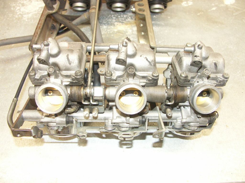

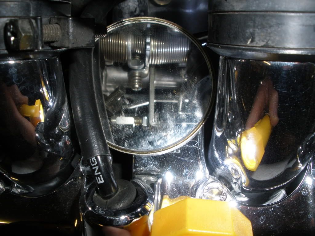

« Reply #3 on: May 22, 2012, 10:22:39 PM »
I have no idea what you are trying to figure out.  Maybe these photos will help.
Note that these photos were taken with the help of a mirror so everything looks backwards even though these are the linkage between carbs 2 and 4.
Bigwolf

« Reply #4 on: May 23, 2012, 11:46:11 AM »
Hi Mr B...How ya doin? Yes, we can do that...if nothing else have an adult beverege or whatever together. Do you ever go the the main street pub across the street from the Humble cafe? I see a black valk parked there often. Say when so I can check my sched. Thank you very much for your offer. I am gonna look at wolfs pics...I think thats exactly what I need. I was thinking about maybe flagging down a valk just to look at the linkage...dumb azz me...should taken more pics! Embarrassed

Big Wolf....thats very very close to what I am looking for. I couldnt see how the tab (the one with the sync screw and springs) actuated the other tab on the other carb. When I get home tonight I'll try to put it together like your pic. Man, thanks a million for taking the effort to take those pics..I really really do appreciate it.

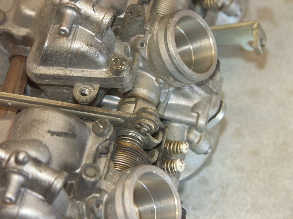

« Reply #8 on: May 23, 2012, 07:13:06 PM »
Here are some photos of the springs and linkage on both sides of my carbs. Hope these help with your problem. These are off of a '97 standard.

« Reply #9 on: May 24, 2012, 09:04:28 AM »
PCV...I see it! Its in the 1st pic,  the 3rd & 4th pic.
In #3, the piece of linkage with the yellow nut on it has a bent tab on the end . I can now see that that tab fits between the lower sync spring and that the tip of the sync screw its self rests on top of the tab. Turning the screw will move that tab in order to open and close the butterfly its attached to. Thats where my confusion was...whether that tab fit between the lower spring coils of the sync screw assembly or on the bottom of the lower spring mount. Now I think I can put this thing back together. Thats a lot of stuff crammed into a tight space..springs tubes and so on.
Are in still working on those carbs or are those pics from the past? Man those carbs look as nasty as mine and its a 2000!
Thanks again for the pics and help. I'll be glad when this task is done.
