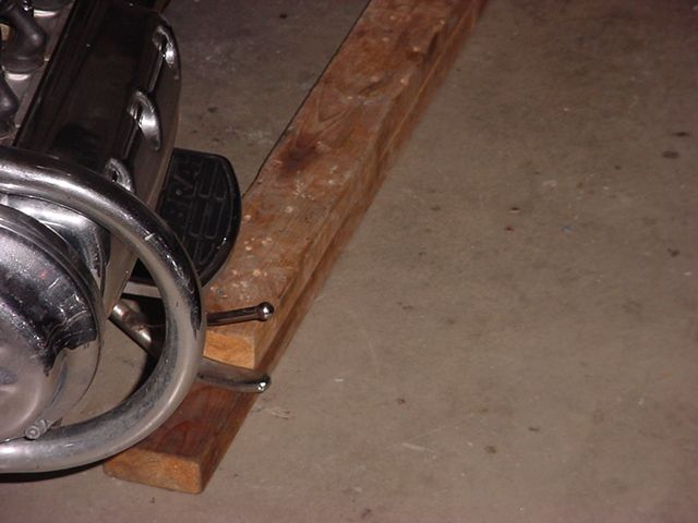

Putting a 2x6 under the stand and holding it more or less upright<1st pic>

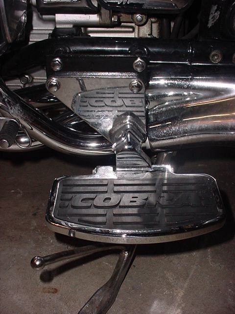

The right side foot board is 8 inches above the ground.<2nd pic>
I must have gotten something mixed up or you read it wrong in your head.
My floor boards are lowered 1.25 inches from stock.
So that I could shift the bike comfortably.
There is nothing unsafe or way out of whack here.

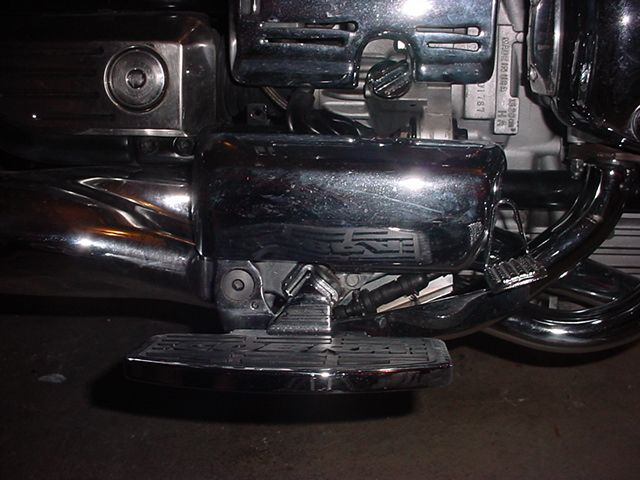

Here is a pic of the factory shifter bent. "Z"ed I'd guess you would call it. I also removed the wire guard on the inside. It looks twisted in the pic for some reason but it's not. I found this to be the best solution for me.  It gets the shifter out far enough that you can adjust it up a tooth or two and still be able to get on top of it to down shift without your foot hitting the head. I liked the MC Enterprises floorboards but not the heel toe.
