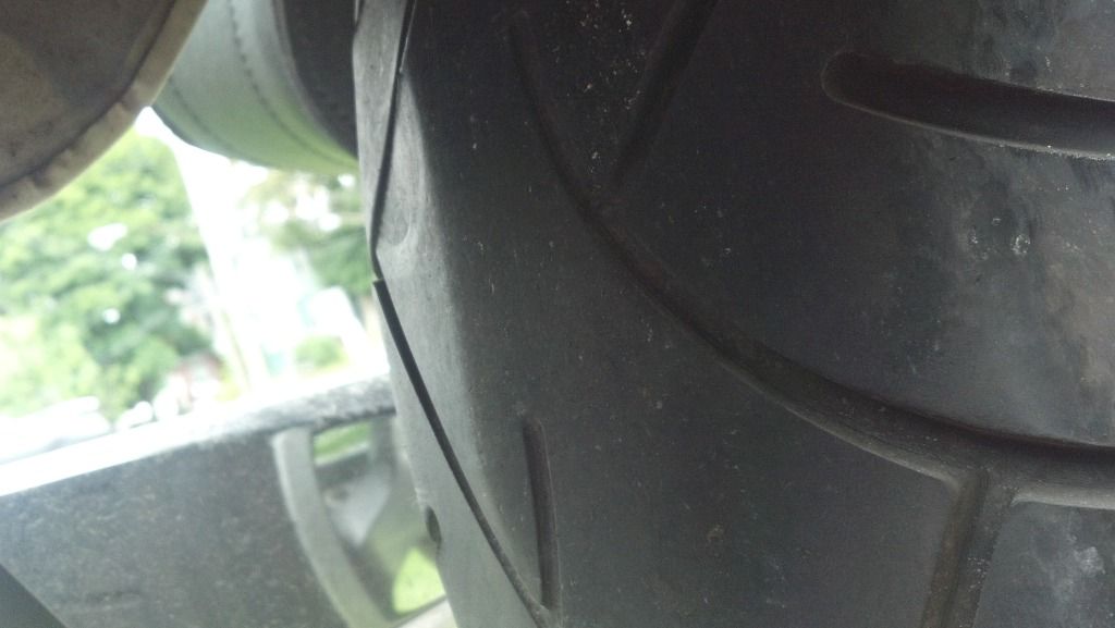

« Reply #14 on: June 02, 2012, 05:23:38 PM »
well i got time to put the gurl on the lift after work this afternoon to check for bad bearings and see if i could feel any play in the u joint and to my surprise(and joy) i found no slop and the bearings felt smooth as did the u joint no slop that i could feel in the joint itself the only noise was the brake pads rubbing a bit while spinning the wheel. but take a look at the rear tire
in this one you can see how choppy it is when i picked the bike up tire pressures were stock im running 42 rear 40 front for the past 1000 miles or so judging by the chop itll smooth out by the time i need a new one lol
so im happy that nothing too serious was wrong but i do intend on ordering the proper grease and paste and o rings and lubing everything up soon as i can afford to. thanks again for all the info and input.
Once a tire is scalloped, it will stay that way until it's replaced - they won't ever smooth back out.
What is your tread depth in the center of the tire?  It looks a little bit low.  2/32" is the minimum - that's also the distance from the top of a penny to the top of Lincoln's head, so if you don't have a tire depth gauge, you can use an upside-down penny.  Wink

« Reply #16 on: June 02, 2012, 09:21:57 PM »
yeah i am familiar with tread depths and the like ive been an auto tech for almost 20 years and a nys inspector for 5 im figuring ill finish this season and figure out what i want to do for next spring possibly darkside and if i wanted to i could smooth out the tire in an afternoon but it really isnt that big a deal at this point im just glad everything mechanically seems sound at the moment. i also took apart and cleaned/lubed my start button today that was a barrel of fun let me tell you lolbut now it works great so all in all a good day with the fat gurl.

« Reply #17 on: June 03, 2012, 05:55:24 AM »
I will tell you that your Valk will be much harder on tires than your Shadow was, and you may or may not believe me, but that's your call.  It's a much heavier bike and the power it has compared to a Shadow is no match.  This tire probably won't last a whole season in that shape if you ride more than every other weekend.
