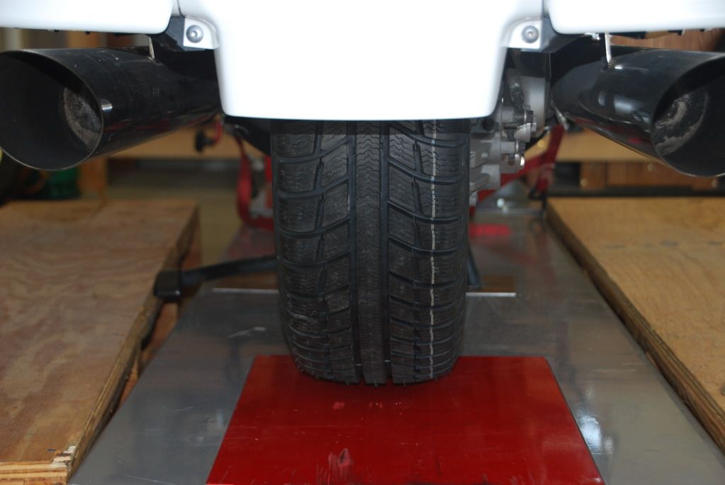

Here is what the Michelin looks like on my wing. 195/55/16.

« Reply #6 on: June 05, 2012, 09:12:01 AM »
I like the looks of the Michelin. Where did you find it in a 205-65/16?

« Reply #7 on: June 05, 2012, 10:23:07 AM »
I got it in 205/60/16

« Reply #14 on: June 08, 2012, 07:41:15 PM »
Brown truck brought the Michelin today, damn that tire looks big. Got a busy W/E and jury duty next week so I wont get to work on it till the end of the week.
