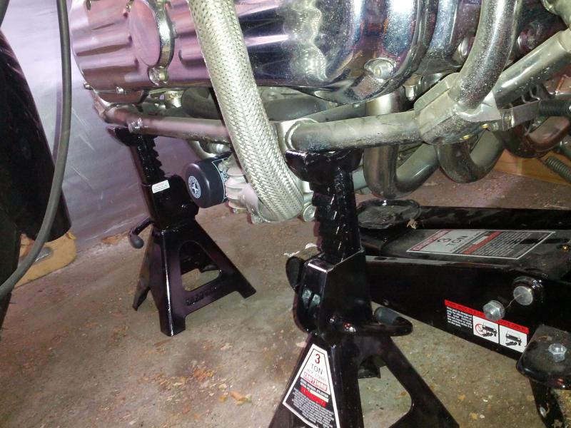

Hi.
So I need to change my tires, and I have two jack stands and a 3-ton lift.
I've raised the front wheel to prop the front off, but is there a safe way to lift the rear up using what I have? Or should I just bite the bullet and buy a lift?
And yes, the rear wheel is chocked. It's pretty stable and is not going anywhere as it is now.
Any recommendations on a decent, inexpensive lift? (I'm assuming the answer to the above will be (Dude, just buy a gorram lift, you idiot.") Found a couple of lifts at J&P Cycle.

I built the lift for my floorjack over the winter, but still use the floorjack and jackstand method most of the time. USe a piece of 4x4 on top of the jack pad and place it against the crossmember for the kickstand.  Let the jack do the rest.  Use caution leaving the jack overnight. Most don't hold very well.   I usually lift mine a bit high and then lower it onto a piece of 2x4 set between the jack fram and the lift arm.

1.  Put two jackstands next to the crash bars, one on each side.
2.  With the bike on the kick stand,  put a wood block (2x6x6) on the car jack lift seat and place the lift under the engine block from the left side. (shifter side)
3.  Place the right side  (foot brake side) kickstand under the crash bar where you want it to be, out of the way of what work your doing. Lift the bike from the right side, as if your going to ride it and line up the right jackstand (set the jackstand as high as you can) under the crash bar. Place the bike back down on the kick stand.
4.  Go over to the left side, check the placement of the car jack, lift the bike again as if your going to ride, as much as you can,  it should hit the right jack stand, and start lifting the bike with the car jack.  Sometimes I've done this while sitting on the bike so I can watch the right side jackstand and hold the bike up also, sometimes I just balance the bike from the left side.
5.  Once I've got the bike at the height I want, I slide the left jackstand over and under the crash bar and drop the bike slowly onto it.  The bike is suprisingly steady just on the right jackstand and the car jack while you do this.
6.  Put the kick stand up.

Ricky-D
Posts: 5031
South Carolina midlands
« Reply #19 on: June 04, 2012, 08:37:36 AM »
The adapter made for the Valkyrie is the best money you can spend to insure a good safe lifting of the bike.
A few minutes to install the adapter and the bike is ready to lift.
The two jack stands on the crash bars is just Ok, a little twisting of the bike when working on the rear and those stands (one of them) will easily slide off the bar and the bike will come crashing down. A more positive way to connect the jack stands to the crash bars to keep them from slipping off is really necessary.

jabster
Posts: 87
« Reply #21 on: June 04, 2012, 10:30:24 AM »
I started to lift the rear tire up this morning, with the crash bars on the stands...got scared...said screw it.
So I got the Craftsman. For $80, it's definitely worth the peace of mind over the car jack.
