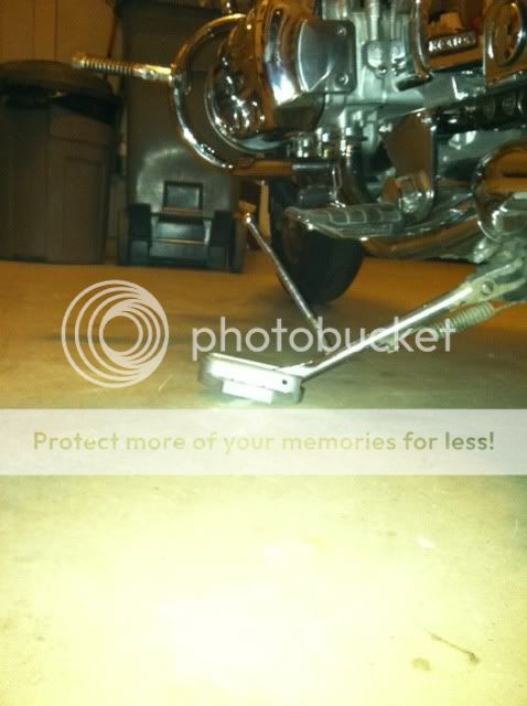

My kickstand on my 1999 Tourer is short allowing the bike to lean over further than I would like by at least 2 inches. Does anyone know of a longer kickstand or some better way that would fit that would take the lean angle from the bike? It's just to far makes a struggle for me when filling up with gas getting enough in the tank and when righting the bike in some areas.

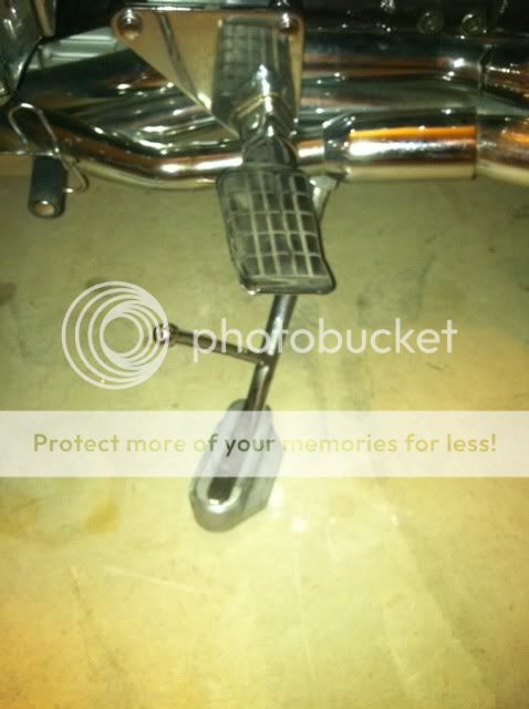

  My 99 Tourer wasn't bad but a lot of times I will park in desert and always worry about it sinking in.  I was carrying a small piece of wood in bag that was a pain to get out, put under stand and then remove when I left.
my rememberer sucks most times, but didn't Tank_post do a run of kickstand pads recently too?
   This works fine and does lift bike some.
Thanks tank_post
Don

But look at your first picture, the foot is not flush on the ground. If that picture is showing it correctly, then your stand is bent outwards. I know mine was flush/smooth on the floor.
I go back to my first statement, WHY? You are only placing a bandaid on the problem.
