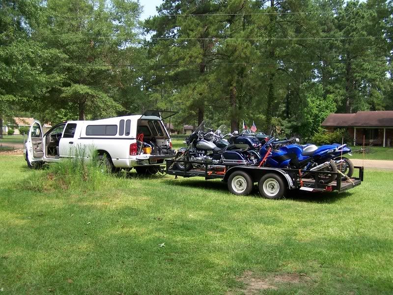

For the front I use soft straps around the bottom triple tree.  Walley World has them for like 2 bux a pack of 2.  for the rear I usually tie to the bottom bag guard  Front I pull forward and out, rear a little out and down or a little forward and down.  Use good quality ratchet straps and make sure they dont contact any paint or chrome.  Turn fuel off, and put the kickstand up.  Not necessary to bottom the forks, I usually leave 1 1/2 or 2 in.  Chreck every gas stop for loose straps, and anything unusual.  Trick is you want no movement at all between the bike and the vehicle.  I tow a lot and this works.

Make sure you use the strongest strap you can find. I made the mistake of using a thin width strap on one side last year and now have the scratches on the tourers bags to prove it. Use large soft ties on the bottom triple tree and keep checking them frequently. The straps that RJ has pictured above are perfect
Do not use the orange size in picture below.. a sharp  turn entering a truck stop at 3 MPH proved
fatal for the orange strap...It was a bad few days for the tourer as a couple of days later I let it fall over on the right side from a jack in my driveway. I now have just about matching scratches !
