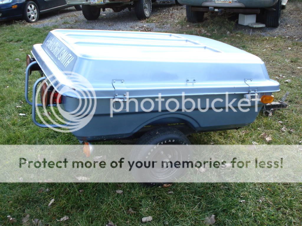

I just picked one of the hoppy 48915 converters up tonight from o'reillys auto parts.......yeah they had to order it for me but it's a next day part so it wasn't a big deal.  Well it wasn't a big deal till I pulled the end cap/cover off the converter and the ground pin was broken off inside the cap tickedoff tickedoff
Here's the one I got to convert the 5 wire system to a standard flat 4 that I put on his trailer:
http://www.hopkinstowingsolutions.com/products/vehicle-wiring-connectors/taillight-converters/tail_light_converter_60.html
Oh well they have me another on ordered already and should be here tomorrow so I can finish up the wiring on my uncle's wing and trailer that I put new lights and wiring on.
Started with this:
After new lights, tires and a custom rear bumper:
Dragon Slayer 129
