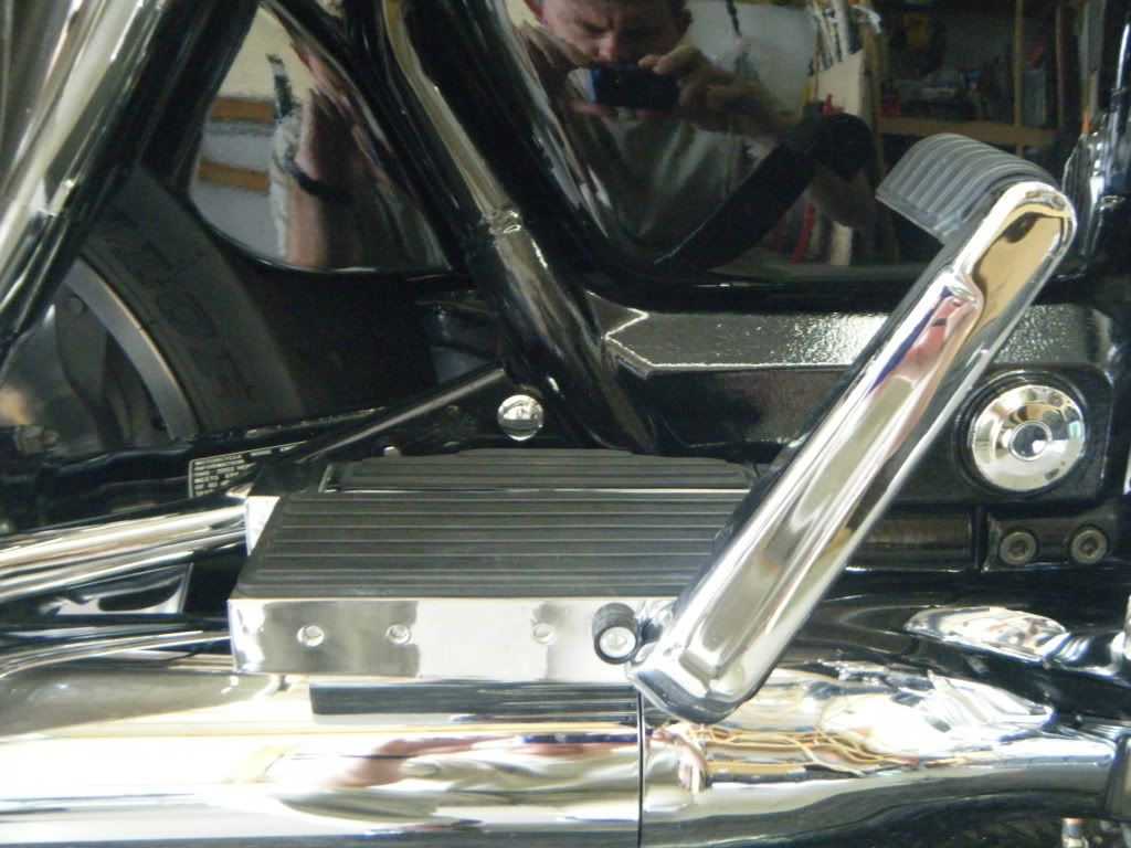

Kuryakn Passenger Transformer Boards with my own custom made mounting brackets

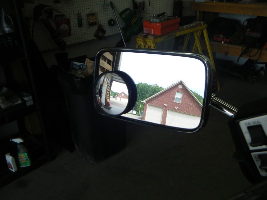

Spot mirrors

Could you expand some on the Transformer board mounting,, I got a set of
GL1800 stock pass boards ($10 shipped!) and I know I'm going to have to
adapt them to the IS.
...ED

The passenger boards are straight from Kuryakn's line-I think made for Harley. Found the part numbers by searching on the forum here and looking at the Kuryakn and Dennis Kirk websites. They were around $280. I bought a set of adapters where they would just bolt right on where the factory pegs do but they stuck out too far and only mounted with one bolt making them a little wobbly. I purchased some 1" thick x 2" x 4" billet aluminum and cut it with a jig saw and bored some holes in it. Took the entire stem that attaches to the passenger pegs off and hard mounted my bracket to the factory stamped bracket that connects the frame and holds the pipes up. Works great and only cost $20 after some stainless bolts. Not sure how factory GL1800 boards would do but sure it could be done.
