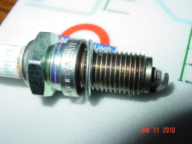

« Reply #21 on: August 12, 2023, 06:36:16 AM »
Well I have had two NGK plugs quit shortly after 10,000 mi. on two different cylinders on two different 10,000 mi. intervals. No fouling just quit working thus led me believe the 8,000 mi. interval had some merit to it though I believe these plugs should last MUCH longer. I went to iridiums for much better cold starting as I done with my VT1100C with great success. 14,000 mi. and no issues. Other than wheel bearing failure and starter button failure these are the only issues this bike has had in 49,000 mi. No choke needed only after winter layup/startup. Both failures occurred on cold start with the use of the "enrichner"/choke. Basically there's always exception to everything but in agreement that the stock NGK plugs should last longer than this. Let the flogging begin.  Smiley
