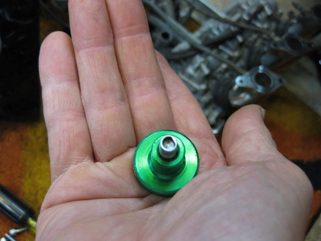

Began to adjust the pilot screws. I bought the tool from pro motion. Did the initial setting [2turns out]
on  #5 & 3. Attemted to do #1 uhho the screw was TIGHT wouldn't turn in or out. I,ve pulled the intake tube off and still can't turn the screw. I stopped and am now asking for HELP.
I'm afraid to try 2, 4,& 6. Whad I do wrong?

The motion pro tool is a very good tool, but you can't get enough leverage if you have a siezed pilot.
Take the bit out of the tool, insert it in the carb and try turning it with a wrench, a socket wrench or something like this, from Sears or Harbor Freight.

Since I struggled to find the tool on the Motion Pro web site I'm posting the link to it:
http://www.motionpro.com/motorcycle/partno/08-0242/

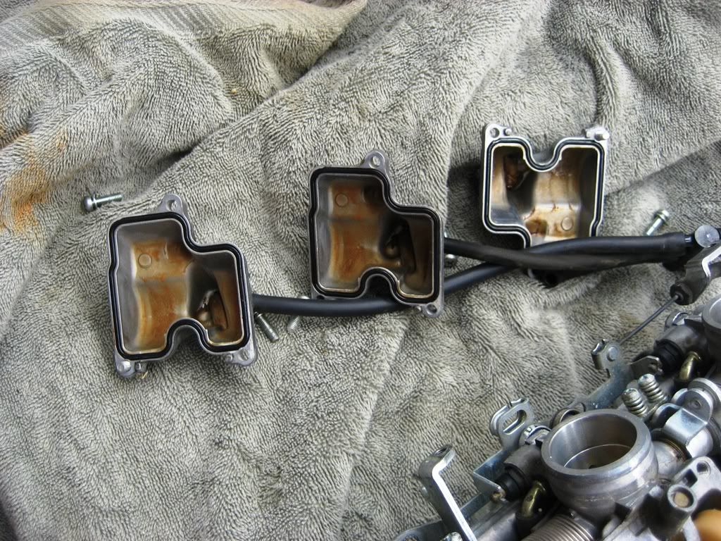

If you are going to go as far as to remove the carbs, I would open up the bowls and clean them out. Spay some gumout in the pilot holes and blow them out with compressed air. Maybe even consider replacing the slow jets while your in there.
Any time you put anything threaded into aluminum anti seize is your friend
