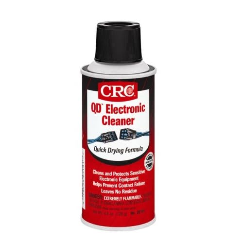

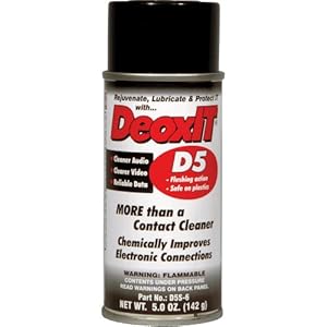

« Reply #4 on: December 13, 2012, 09:17:19 AM »
Keep the hose off this part of the bike.
Spray all control switches with cleaner lubricant before (I do it after) every wash.
Blow the bike off with a gas leafblower after wash. (from top down)
