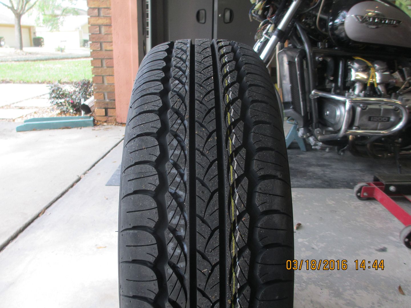

So, I got my 205/55r16 today, it measures 8.5" wide.  It is a KUMHO Run-flat.  It sure looks wide!  I am putting on a 2000 Interstate with a trailer hitch.  Can I make it fit in there??  I had a tough time taking the stock size out of there.  I know about the cage mod, but I think I am going to put a hex head bolt in from the inside to gain some room.  Should I send it back and get a 195 or do you think it will fit??  This is my first time with this, crossing my fingers.  I have read all of the stuff on here and everything pointed me to that size, it's just so darn big!!

« Reply #27 on: June 24, 2017, 07:13:03 PM »
Yes, a 205 55 should fit.  Except I cannot say with certainty your particular run-flat will fit.  As I understand it, they have thicker as well as stiffer sidewalls.  I know some here have successfully run run-flat tires, but I know nothing of the manufactures they used.
Cut your cages out.  You can use carriage bolts inside out with acorns on the outside.  You can probably reuse the OE big square nuts with no problem.  I used skinny regular size hex nuts.
When I got my 1st 205 60 (not a run-flat), I tried shoving it up in there without the wheel and it didn't fit.  Luckily, when you mount it on a wheel and add air, it does fit.
If you haven't already, get rid of your OE rubber valve stems with elbows (which often crack right at the wheel from age, stress/torque and abusive inflation techniques/bending, and can lead to a traumatic deflation at speed), and replace with 90* metal stems.  Some tighten on the inside, but people seem to prefer the ones that tighten on the outside.
