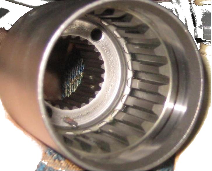

I won the bid for a 1500 gold wing final drive on eBay yesterday for $39.00... the picture of the splines was murky, so I called the seller who inspected them and said they showed no wear. I looked at shop presses too... I don't have a place for a shop press, and a lot of people on mechanic forums foo foo the $200 20 ton shop presses with bottle jacks anyhow. Plus, people like me who don't know what they are doing can hurt themselves with shop presses... My local NAPA place has a shop with that kind of stuff in the back, I used to go there and the guy was happy to use his giant compressor to blow out my caliper pistons, so I guess I'll go there to get the splines pressed out of the 1500 wing ring gear and into my Valkyrie ring gear. I have two final drives with worn splines... we'll see if I can refurb them and maybe even paint them so they don't look so bad... there was at least one year that final drives weren't painted gray, they were polished and clear coated, I don't think I'm up for that  Maybe there's more to this than I realize, maybe not, I'll find out  -Mike

Stage one: the wing final drive arrived today. I daubed some of the goo out of a few of the splines, they look sharp   I got the drive shaft, too... it's not the same as ours...  -Mike

Thanks for the pictures ....Keep'em coming as you move forward with this Well... It came apart easily enough, the bearing feels good, but doesn't want to come off easily...  But the sharp end profile of the splines fooled me... here's a good look at what I have...  Good splines look like this...  one or two missteps like this and it would be better to just buy a new ring gear for $250...  I reckon I'll give it another try, anyhow... maybe I can find a good wing final at the local trike place I visited a year or so ago... hope they're still in bidness... -Mike

That bearing is a doozie, i know. Sorry to hear about the bad splines. Those wing splines are not as bad as most that I have seen. I would be willing to bet that you could find a 'wing ringgear SOMEWHERE for a decent price. There are thousands of triked wings on the road. Aftermarketly triked. Speaking from experience: Be very careful with that seal that seats around the ring gear on the final drive. (the one in your last picture above) I poked it wrong w a screwdriver and ended up having to tear the whole blasted rear end back apart and order new seal from HDL. If I were doing it again, Id just order a new seal to begin with. Also, the little brass collar that the 'elusive 3rd o-ring' sits on, is pressed in. Order a new one from HDL. It will be much easier than trying to get that old one out. i promise. It is part number #14 on the schematic of the valk final drive. Ps. My new ring gear and drive flange sure were pretty. Pretty expensive, but pretty awzome. But hey, if you can save a buck, do it. Also think about replacing the wheel dampers. Made a great difference for me. Wanna see bad splines? here's a link to my recent rebuild: http://www.valkyrieforum.com/bbs/index.php/topic,47765.0.html-Safe winds, Okie

The splines in the second wing ring gear seem like maybe they were starting to get shiny on the wear side, but I guess I'll go with it... ?  I'm going to go take a Valkyrie final drive apart now  -Mike

The picture in post #30 seems to show a bit of wear, maybe 20% or so.
If you were to use this spline in conjunction with a new drive flange I think initially, they would match up pretty quickly.
But then settle in, and give many years of good service as long as you service them regularly, whether you use a time period or miles on the bike.
