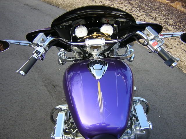

« Reply #10 on: November 13, 2012, 07:17:44 AM »
I mounted a MS Batwing a few years ago, added the lowers and already had the fork wings, so there is not a lot of buffeting at all. I love this thing. I had heard of problems with the mounting proceedure, but I never experienced any of that. It goes on/off easily to clean stuff. My only issue is with the windshield height, since the top is right in my field of vision, but it's very dry in the rain and keeps the blast off your chest.
It is light weight and acually smooths the ride. I painted it to match and would do it again.

I have a Memphis Shades batwing on my Valk as well.
I love the way it looks. As others have said, easy on and off. Not so much on the initial install, that was a bit tougher. I have a short tinted shield installed now...looks great, but to truly be really functional it needs to be taller. Somewhere in the garage I have a taller clear shield for it that I need to try out for cooler weather.
The only downside I can think of offhand is around 115 mph I get a side to side shimmy out of the handlebars. The bike doesn't do it without the batwing installed so it has to be turbulence from that.
