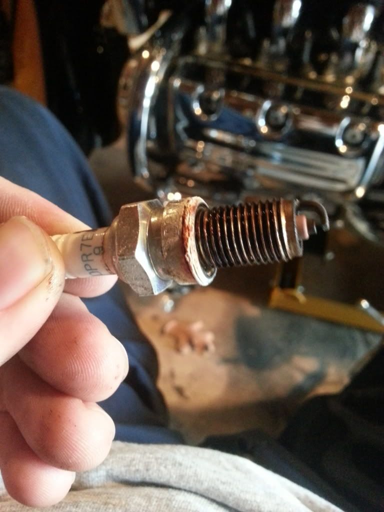

Well, She sneezed again tonight. Several times while riding around the block.
I believe that I have ruled out the spark plugs. They are all brand new, and snug in the cylinders.
I am starting to think that it's coming from one of the exhaust headers. I have not replaced the header gaskets, and I doubt any owner before me ever replaced them. (Because no owner before me serviced hardly anything.)
It is not a backfire, no pop at all. Its more of a PSST. Coming from the engine area, always on the right side.
So my rainy day list is:
1) Desmog
2) Vacuum line replacement
3) Header gasket replacement
For kicks, here's a pic of one of my old spark plugs. This one was in the worst condition.
You can see the weird corrosion.
thanks to all who reply,
-Okie

« Reply #15 on: November 19, 2012, 04:47:02 PM »
Rusty suckers! Good luck with the other tasks.   Smiley

« Reply #16 on: November 20, 2012, 06:58:47 AM »
Wondering if the noise could be a reed in the PAIR valve.  I did a PAIR-ectomy when I desmogged/de-vacuum leaked her.  If you want to keep them in I'd be happy to part with mine.  It's just 5lbs of garbage as far as I'm concerned.
« Reply #17 on: November 20, 2012, 07:12:46 AM »
Those plugs look fine,, they just look as though water has gotten past the boots and set in the 'hole' for awhile.. Maybe the drain holes should be checked just to make sure they are clear..  Did this bike sit outside or the previous owner use a lot of water when cleaning it ??
I was going to start another thread rather than kinda hi-jack this one.. Whenever you find a sparkler that does not want to come and turns hard.. Just stop if it has been turned out 1/8 or 1/4 turn and if you think its going to be stubborn.. Spray it with carburetor cleaner or dump some brake fluid on it and just let it sit for awhile.. Thats time well spent rather than have to possibly heli-coil that hole..
Brian
Posts: 996
Monroe, NC
« Reply #18 on: November 21, 2012, 06:59:26 PM »
There are drain holes in the spark ports? I need to go look for them.
